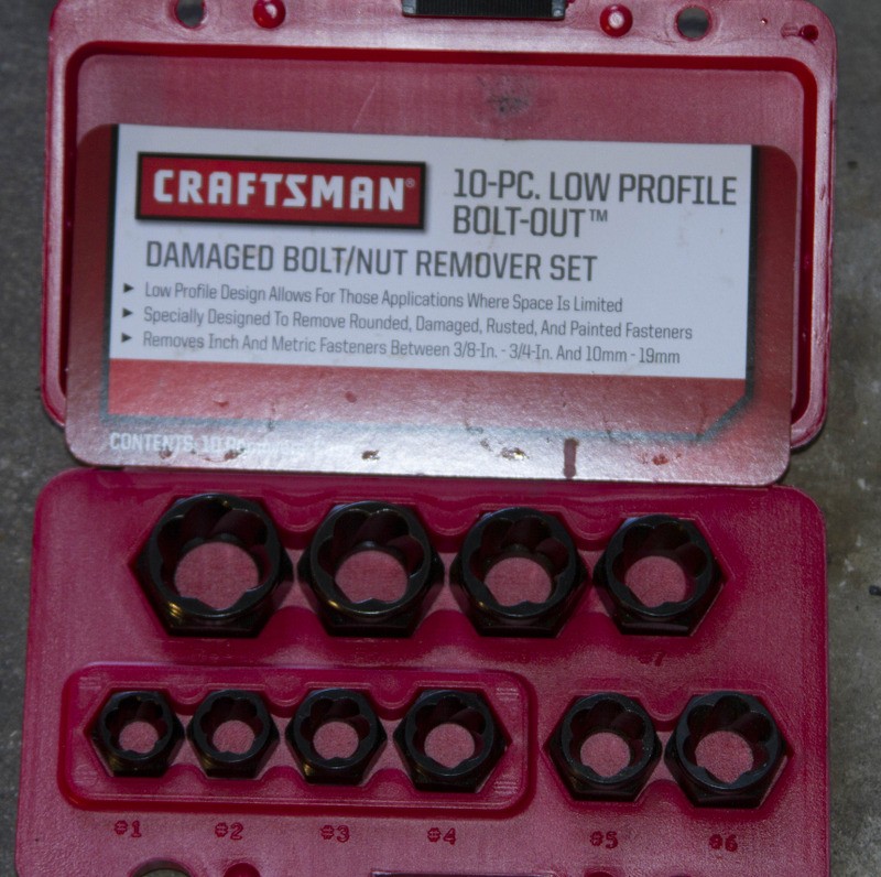

Picked this up a sears and it has come in very handy on bolts that will just not come off no matter how I try or how much PB blaster I spray on them. Works every time.
