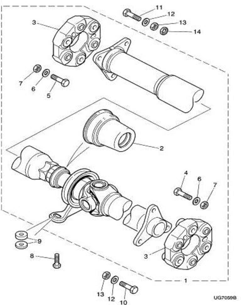

Here is the drive shaft and we do have a flexible rubber disc at each end also called a Giubo. Be sure and note the position of the bolts,nuts and washers if you take the drive shaft out. Jaguar uses the hardware to help balance the shaft and you can create a vibration but putting them in a different spot. Sometimes they are dabbed with different colors of paint to help identify them.
