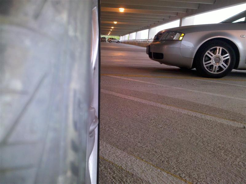

I wouldn't roll the dice here. Here's whats going on...
The tire is comprised of several "plys" of different materials which have been fused together. Usually with a combination of heat, and glue. Now when your sidewall took the impact, basically you broke the bond between some of the layers. The bubble means there is basically a delamination of the layers and a pocket has formed among the outer layers that can hold air. Since air takes the path of least resistance, as do all molecules, that pocket has now turned into a bubble - stretching the outer layers that are still in tact. Don't forget there is 32 psi of pressure in that tire give or take.
Now you could be lucky, and drive it till it wears out like that (I've done it, when I was younger and dumber read: poor) , or it could burst at the first bump you hit the wrong way.
Its the equivalent of having a pimple or blister on your skin. What's easier to break open, a blister or normal skin that's in tact?
Do yourself a favor and just order the tire now. You have a pregnant wife that you drive around in that car. You don't want something happening over something that could have so easily been prevented. The tire shouldn't spontaneously destruct, but it's structure has been compromised. You don't want to ruin a rim by losing a tire, and having to deal with all the BS you just went through.
I'm not trying to scare you, I'm just giving you the reality of the situation. The price of a tire isn't worth the aggravation..

George is right on the money. Don't run the risk any longer than you have to. Get a new tire ASAP. And while you're waiting on it, keep your speed down and avoid any sharp manuevering....
Note: It is usually safer to move a potentially dangerous tire to the rear axle. You're always better off from an emergency handling perspective if you blow a rear tire as opposed to a front tire. I know the STR has larger tires in the rear than in the front, but most cars use the same size all the way around, and this note is for those folks who have identical tires on all four corners but aren't aware that they are better off with a damaged tire being mounted on the rear axle....

As promised, pics of the rim protectors on the Conti's. As you can see it's not extreme, but the tire clearly sticks out past the rim, enough to protect it from light scrapes. I imagine the rim would still touch if you really ran it against the curb.
