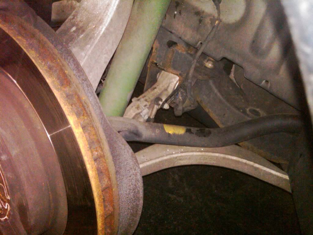

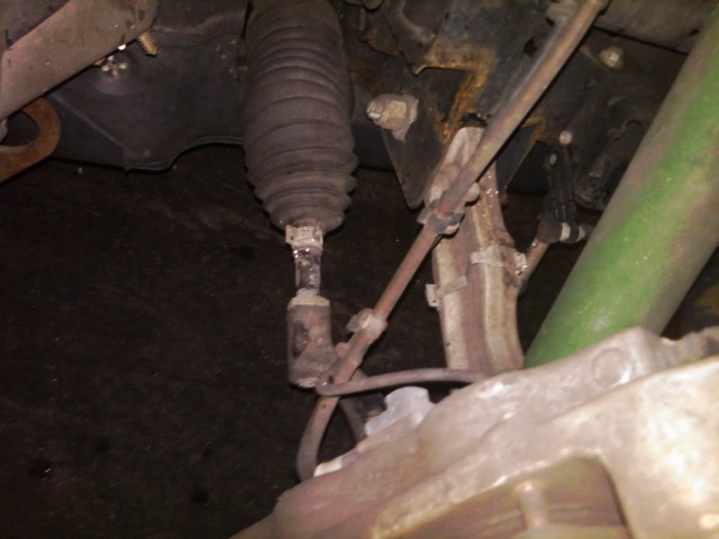

Hey guys, again, thanks for all the kind remarks. I took some pics with the front wheel off, we couldnt find anything bent or out of place, but to be honest I didnt really know what I was looking for. So i took a few crappy pics, couldnt find that inner control arm that Bytor was talking about, or maybe I did but just didnt know it.
Anyways, the front rim and tire are fine, thank god! We threw it on the Hunter wheel balancing machine and it looked fine. He took the stripped lug off at no charge and did not damage anything, which was good. We ordered the matching rear tire, but wont be in for 5-7 business days! So at this point I have to pray that the rear tire is not bent, and the alignment I bought will work out. Thanks for posting the full specs from BRUTAL, i think my list was only partial. I will be printing that out and giving it to them. They are well aware of it, and the lead technician is the only one to be working on my car (supposedly), but the kid seems like he knows his stuff.
So even with the most recent Jaguar alignment updates, they are still incorrect for the STR? I trust and respect Brutal tremendously and have no problem using those specs from the other post, just wanted to make sure there wasnt a more recent update?
Anyways as you can see from the invoice that pothole was not only a nightmare, but cost me a pretty penny. The tire price includes the mounting, tax, and shipping. They are going to road force balance the new rear tire, and do a full alignment. I guess that is when I will really know if there is any damage.
Again, thanks for all the concerns, comments, tips etc. Much appreciated.
