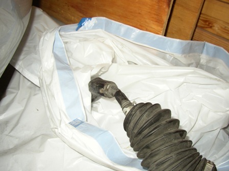

Originally Posted by Bull27
Hey guys, again, thanks for all the kind remarks. I took some pics with the front wheel off, we couldnt find anything bent or out of place, but to be honest I didnt really know what I was looking for. So i took a few crappy pics, couldnt find that inner control arm that Bytor was talking about, or maybe I did but just didnt know it.
Bull,
The first picture after the invoice got it. The metal piece (about 3/8" in diameter) sticking out of the rubber boot. If you take the boot off, you'll see a metal piece that threds into the steering rack assembly. That's the little sucker that caused me so much pain... It's about 6-8" long.
BB

Originally Posted by Bytor
Bull,
BB
Ok yep, I thought that was it, looked familiar. Now do I need to take the boot off to check or would I be able to tell by the visual inspection I have already done and the soon to be alignment? That whole thing bent on you or just where it attaches to the steering box? Damn, I'm shocked that thing would bend so easily if you hit a pothole going straight, now if u slammed into a curb with the wheel turned, that's another story. Thx.
As far as Bytor, I believe he ran over some obstacle in the road at speed. And Bytor, feel free to correct me if I'm wrong... As far as your car, I definitely believe that your rear wheel took the brunt of that impact. Consider yourself lucky in that respect as it's much harder to bend the static components of the rear suspension.
If it's going to bend, it will be visible... And the car WILL NOT align properly - one side of the suspension will be geometrically different than the other, so you will never get the wheels in the position they need to be relative to each other. If it aligns fine, then no worries, nothing is bent. All in all seems like you just blew out a tire... Just in probably the most inopportune way imaginable.
I know you mentioned talking to Brutal as far as as alignment, but would you mind posting your "after" alignment printout as a reference guide. The shop should give it to you.
Mine bent where it was visible. Approx 70 degrees angle from true... You do not have to take the boot off to check it. You'll know when driving since one wheel will act properly, while the other sort of does whatever it wants except turning properly. I drove mine 70 miles on the highway like that, probably the strangest drive home ever...
Now, I can't explain how the bend occurred. No sideways impact at all, but I may have dropped it to the pavement when the tire went down, but I still cannot explain it. Others have speculated that the tow truck may have bent it (or dropped the car hard enough to bend it), but that's a tough one to prove as well. The mechanic said I must have hit a curb with it, but I know that's not the case...
Here is a good and bad pic of my inner control arms...
I can almost bet a bend like that was caused by the tow operator. No way that touched the ground when you lost the tire... A bend like that would require an impact with a solid object, and would have left a severely damaged wheel in it's wake. The bend is front to back, so the wheel would have had to physically shift in the wheel well.
Were your tows done on a flatbed or a wheel lift? And did have the wheel lift that grabs the tires or the older style stirrups.
My bet if it was a flatbed in order of probability:
1) he attached the winch cable to the tie rod end, to pull the car onto the bed.
2) he got overzealous with one of those ratcheting straps to tie the car to the bed
Now if it was a wheel lift, that had the car by the wheels, could the fact that both wheels were strapped tightly to the wheel lift, but one had a flat tire cause the bend as the car turned behind the tow truck? That's an interesting theory... Since the wheel lift is a solid bar, but the wheels would be on it leaving the car at an angle.
If it was stirrups, he may have hooked to the tie rod end...
