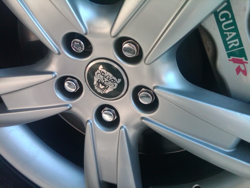

Strange thing just happened. I walked out the door and there were the lug nuts delivered by FedEx. I literally ordered them yesterday morning, and by 8AM this morning they were outside my door. Awesome but surprised seeing as it was free shipping, and they usually use the cheapest method possible.
Anyways, they look great, and match up perfectly with the originals. I am having them throw these on when I get my car "re-aligned" for the third time today, and yes, they come 10 per box (20 for $59).
I have an extra 4 if anyone needs them, I use locking nuts on my wheels.

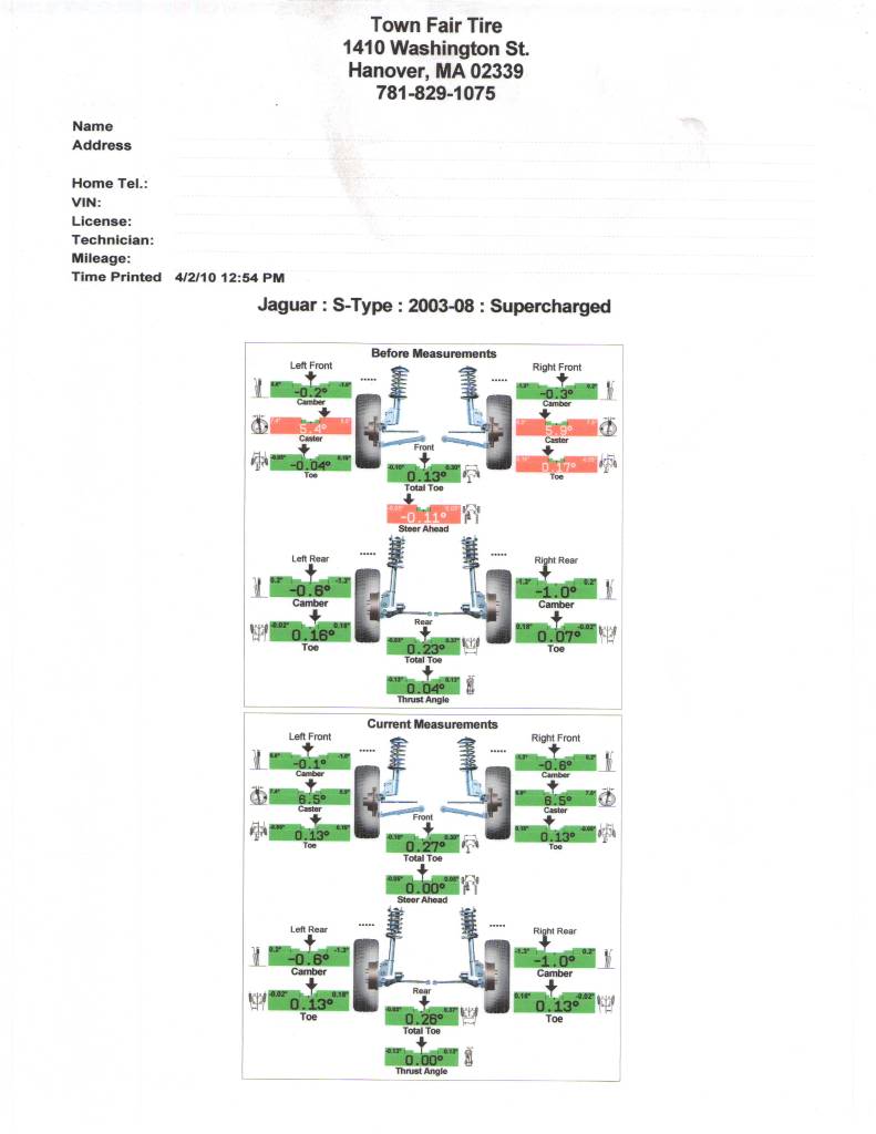

Lugs are on, look great, I think alot better than the stock. Also seems like they fill out the holes a little better, not sure if they are wider, longer or both. Final alignment specs attached, done with a brand new Hunter rack recently calibrated. The recommended tech (by the regional manager) seemed to know his stuff and seemed to genuinely care. Store manager asks him, "so you wont have a problem with his spec requests right", he goes "its not splitting an atom." Thought that was funny because that is EXACTLY what I have been thinking to myself throughout this whole debacle. Drives great, better than the previous two "alignments". If the specs are off at all, I dont really care at this point. Steering wheel is dead straight, handles extremely well around corners, and there doesnt seem to be any sway to the right or left whatsoever.
Rear
FRONT
FINAL SPECS

Very important question, Bull -
Do you now have a 21mm lug wrench in your trunk? Remember, your factory 19mm lug wrench will not fit these new nuts....
If you don't have one, you better get one TODAY. With all the bad kharma crap happening around here lately, you never know when a flat tire is going to strike you once again....
Oh, and I'm really liking that total front toe-in of +.27 that I see on your final set of alignment specs. Keep us posted on your handling as well as your tire wear now....
Well I bought a 4 way tire iron from Advanced Auto Parts, I believe it has that size. When I go back outside I will check.
NOTE: Also the only thing I thought was a little off with this alignment was the front camber L-.1 and R-.6 but the Jag specs actually have them listed as L-.2 and R-.55 so it looks as though this is just fine.

From: Yorkshire, England
Joe - To nit-pick, the jag rear camber specs say R & L should be equal and about -0.54.
But... the new one is wayyyy better than the others.
edit: and if drives good it is good.
Haha, ok, I fought the good fight. Got the thing aligned 3 different times by 2 techs at 2 locations, called and emailed a complaint to corporate afterwards explained to the regional sales manager for a half hour on how his employees should conduct business in a sales environment. Now, i could drive it back and have him adjust the rear, but I think the most important specs are good to go (dont want him to F up the front), drives very well, so i most likely will not do that. Im a self proclaimed consumer advocate (lol), but I need to learn when enough is enough, and when it is starting to waste too much of my time. Time that should be used to make some $$$ instead of di*king around with this type of thing. But hey, the lugs look like they were put on correctly! thats a plus!
PS What would these rears, the way they are set up now, potentially cause a vehicle to do?

haha, I was only pulling your .... leg.
I defer to Brutal about how it'll handle differently to the spec but I think it'll be slightly adjusting for the road crown at the rear as well as the front and I'd GUESS (eek) it won't even be noticeable. On a perfectly level non-crown road (center lane) maybe it'll wander a little left but who'd care??? Heck, it's within spec so we're splitting hairs really. The thrust angle is great and the toe and castor so it's gotta be good.

Bull,
Congrats on getting you wanted and should have gotten from the get go. The lugs look great. Sorry I've been off the radar most of the day dealing with the accident I had yesterday with the X-Type.
I want to send a bit thank you to Bytor, for graciously sending me his stock lug nuts at no charge to get me out of a jam with the S-type. Got the replacement stock wheel, and got the tire mounted and the wheels back on and it drives perfect again. Just in the nick of time too because the X is going to have to be in the shop.
Speaking of Alignments - to say the Xtype is going to need one is an understatement. Take a look in my thread about the accident if you're interested.
I am going to actually order two sets of the lugs from street side when they come back in stock, one for the X and one for the S.
One thing I do want to mention to you Bull. Does that wheel lock nut have a conical seat or a flat washered seat? If it has a conical seat I would NOT torque it to spec (really you shouldn't use it) because it's going to dig into the wheel (which expects a flat washer seat lug nut). I haven't found a flat washer seat 12x1.5 set of wheel locks.

finally, that's a good alignment
