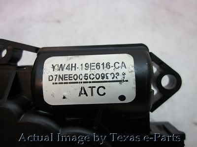

All,
If possible, can someone confirm this:
I sourced a vent actuator from a local junk yard. However, no matter how i try to mount it, the swing arm does not fall into place. I noticed that the part numbers have different letters at the end. For example, some have AA, BA, CA etc..
Does this dictate how the arm swings? The replacement part came from a Lincoln LS.
I know there is a total of 4 of under the dash. The one to be replaced is on the passanger left side.
Thanks

I would be surprised if the LS part would work? The ducting and such are different. Now the sensors are the same but not much else.
I think you need the Jaguar part.
