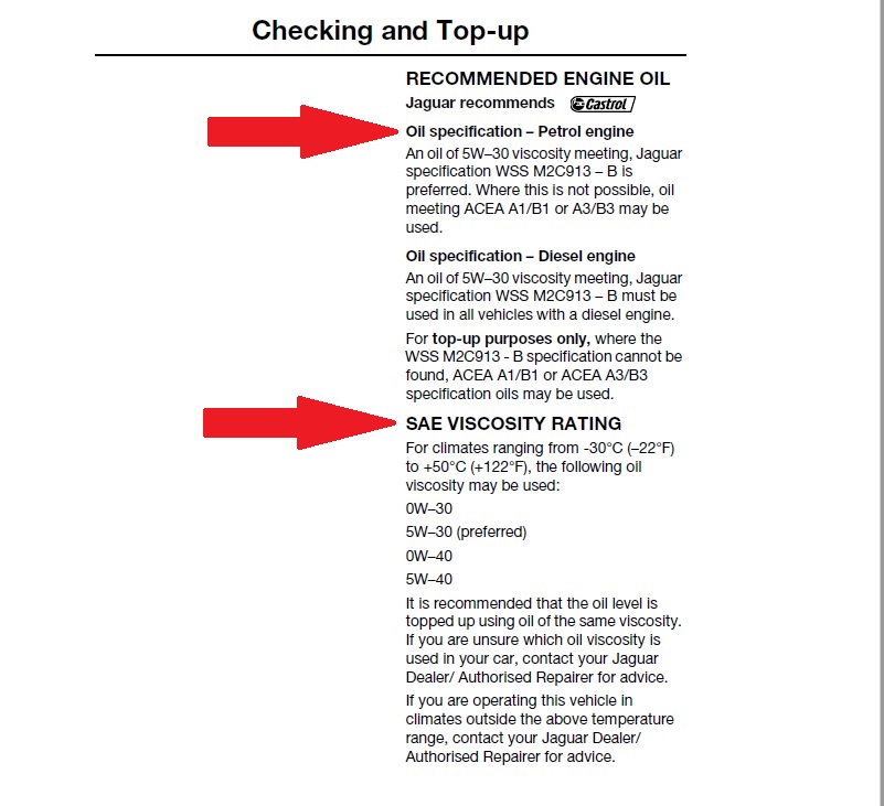

After a bit of looking I found this at my owners manual- "WSS M2C913 – A or B is preferred" for oil engine use. Does that mean that I should look for oil that is Acea A5/B5 spec only?

Old Jun 23, 2017 | 02:50 AM
Likes: 17,005
Originally Posted by NikolaiDiqnov
..... I got the owners manual but it says nothing more than "Jaguar recommends Catstrol etc. etc, use 5w30". But nothing more about the certain specs of the oil. .....
From the Owner's Handbook for the 2007 S-Type:
The oil specification (WSS M2C913-B), alternative specification (ACEA A1/B1 or ACEA A3/B3) and recommended viscosity (5W-30) are all detailed there.
Your forum Signature with vehicle details will appear automatically with your next post.

Except that Mobil 1 (not Mobile 1) 5W30 does not meet the primary spec of WSS M2C913 A or B.
