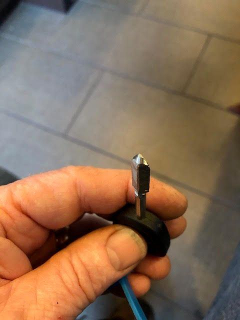

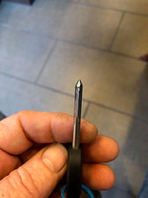

Thank you all your help everyone. The update is wonderful:
1) I sent the fobs to Neil at fingazfobs in the UK. He repaired them completely and now all the buttons work well on both fobs. No reprogramming was needed. 29.50 pounds including shipping.
2) I was put in touch with Craig at The Jag Shop in Portland Oregon regarding the problem of not being able to fully insert either key into the door. He suggested the tumblers were probably misaligned and gummed up from lack or use. It seemed possible to me, who ever uses their key when they have a fob? I bought a key from ebay and ground it as he described (photos below). Low and behold I was able to eventually wiggle it all the way into the door lock. I also used a little dry graphite powder, now both keys work in the door! $30 US.
All in all, much better than the $800 the dealer quoted for EACH replacement key. Thanks again everyone.

Old Mar 17, 2021 | 01:04 PM
clubairth1's Avatar
Community Influencer
Posts: 12,056
Likes: 3,345
From: home
Great result and I learned something today too!!
I will remember grinding a junk key to free up the lock that's a keeper.
