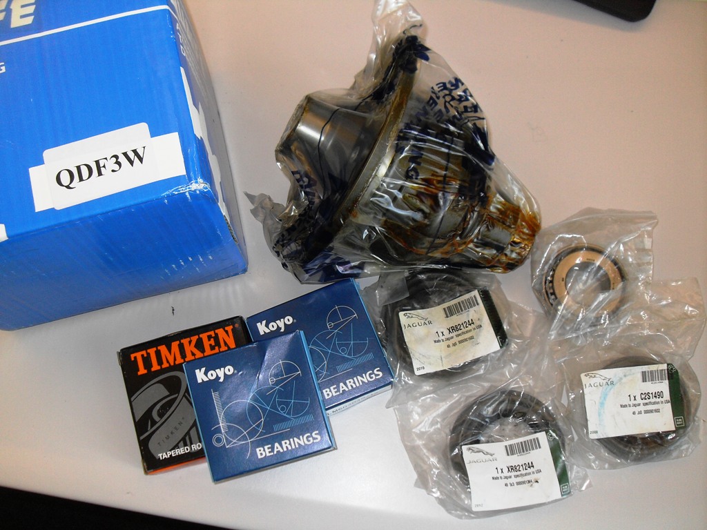

OK I just picked up the XJR from my mechanic...the Quaife is in!
So, QDF3W from TL Jaguar tom(at)tljaguar.co.uk was £695, another £195 for the bearing and seal kit, £80 delivery from UK to Switzerland. Those are export prices without tax. I'm waiting for the bill to come from customs...
This is what Tom sent me.

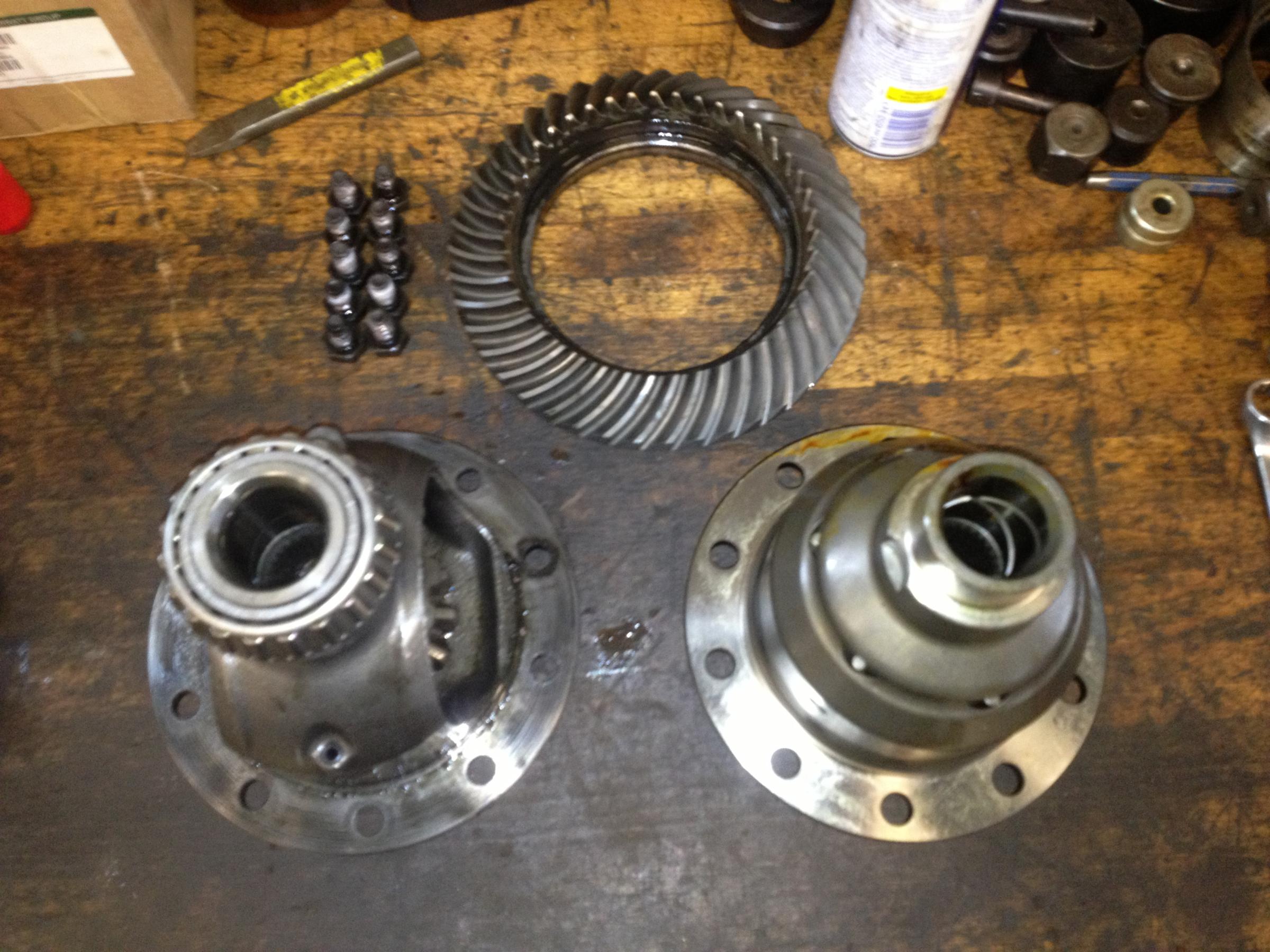

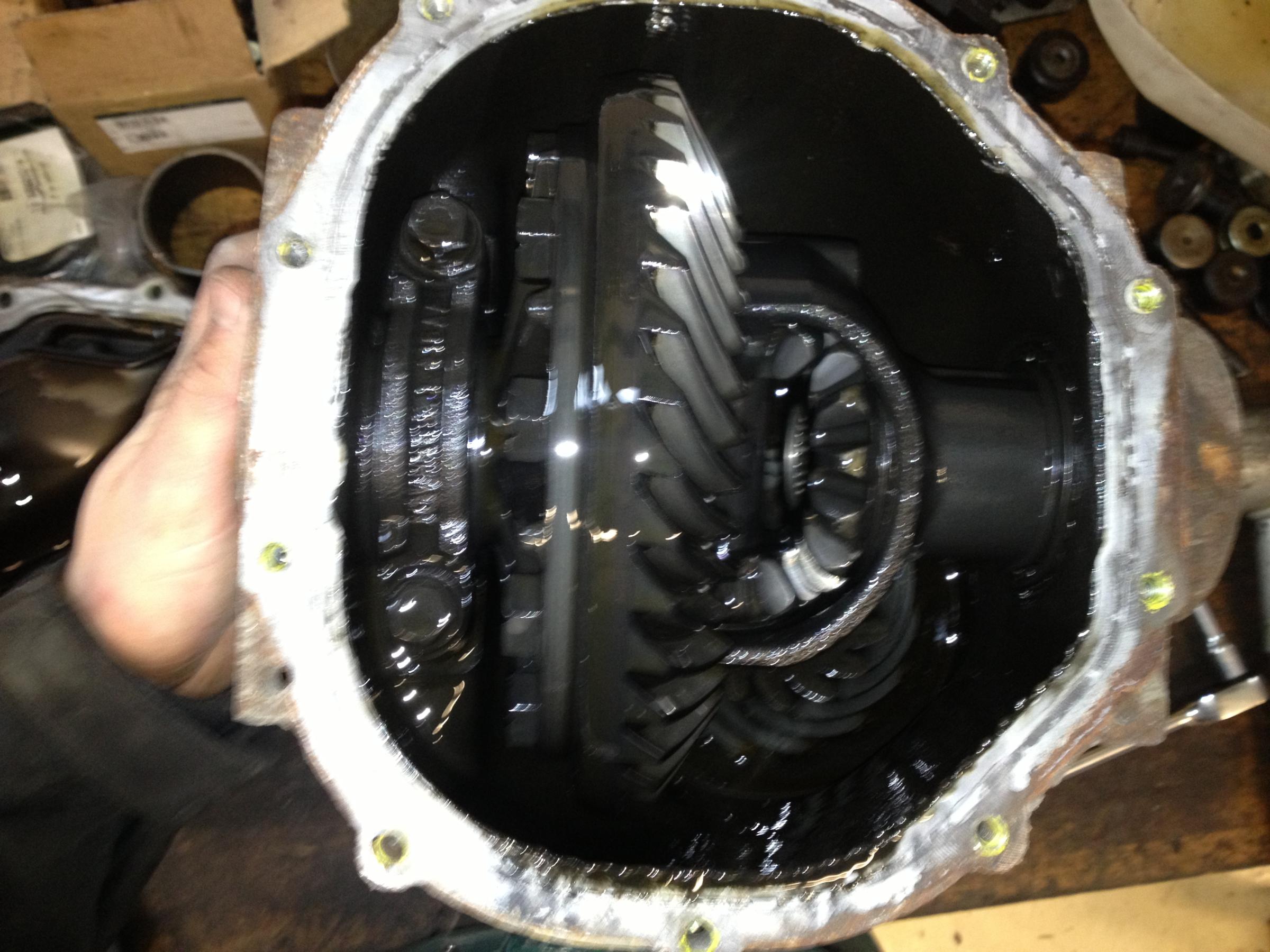

This is what the stock open center looks like inside the housing.
Here the stock center next to the Quaife. Outer dimensions the same.

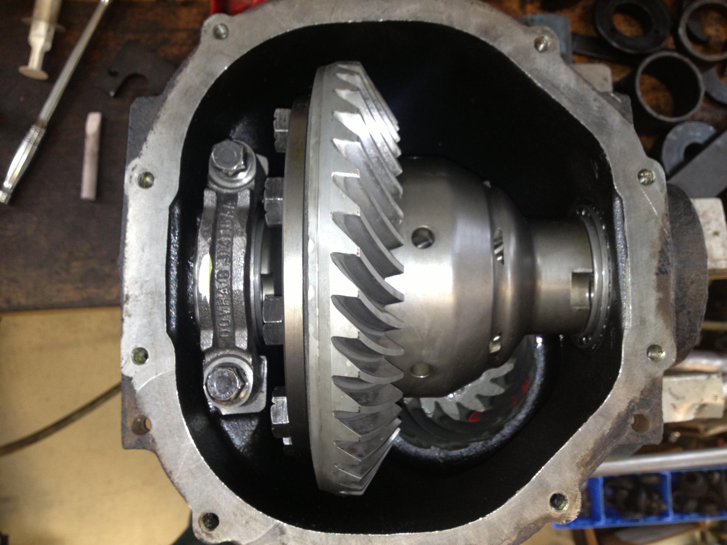

Here the Quaife installed in the housing. Fits in like the original center, no grinding, no modification, it just slipped in like the original unit.

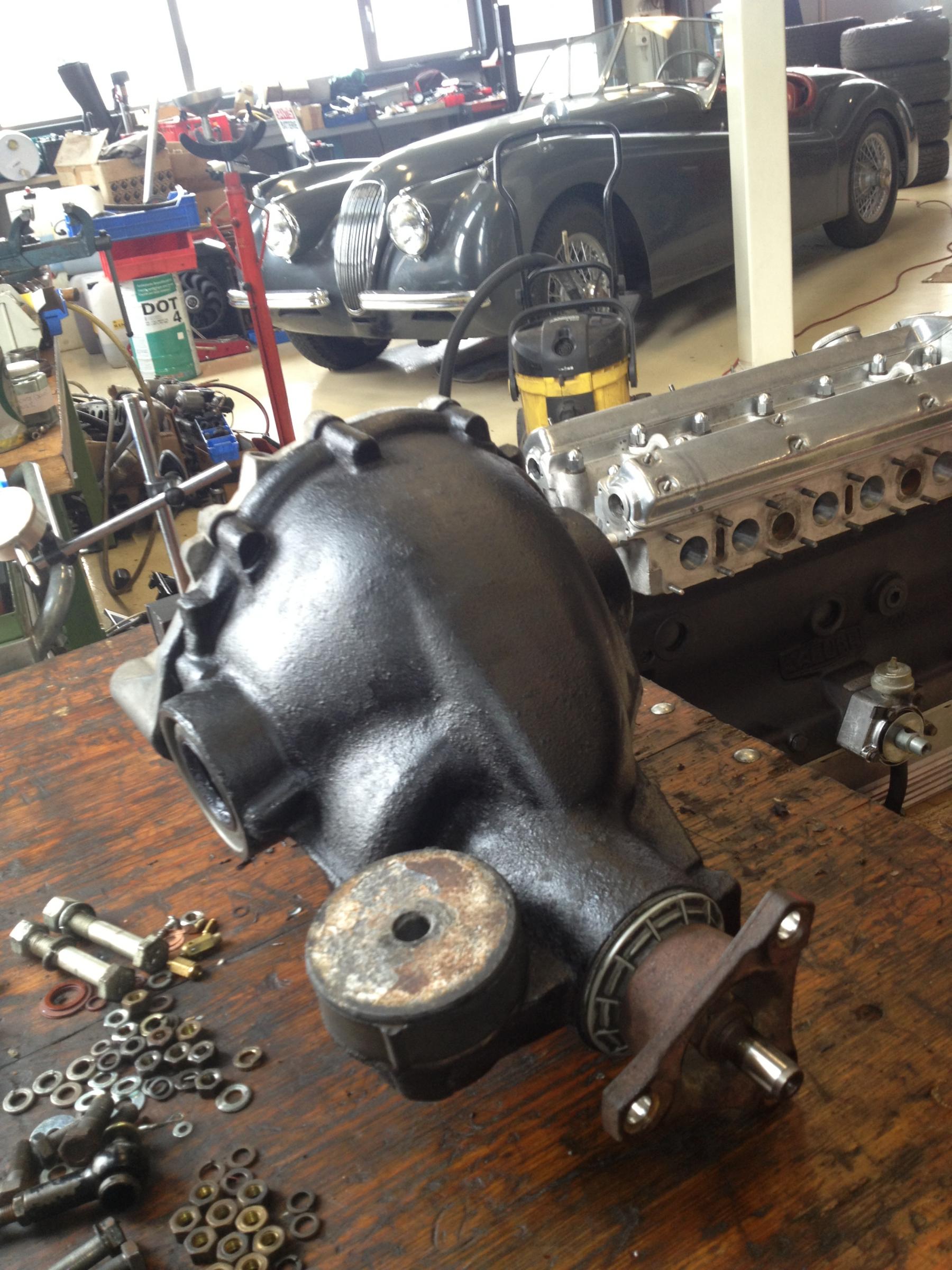

Bolting the finished diff back in. No problem!

Looking at the pic with the Quaife installed in the Jag housing, there is so much space in there i'm really wondering what the problem is to fit an 8.8" clutch LSD in...grind what exactly????

I was looking at the picture of the Quaife installation and one thing stands out. There is only one bearing clamp on the Left side! I assume that the second bearing housing is pressed into the carrier housing. Makes me wonder how strong the housing is in that area.
Old Mar 28, 2013 | 03:36 PM
  #295
GT42R's Avatar
Joined: May 2012
Posts: 1,295
Likes: 252
From: Canada
Yup, noticed that too,
I'm guessing the bearing's outer race/cone is pressed into the housing, the bearing itself is pressed onto that end of the differential, then you load the assembled diff in with that bearing end first, and drop the cap side in next, bolt down the cap, and done,
agreed, not very robust looking... but a bit simpler too...
