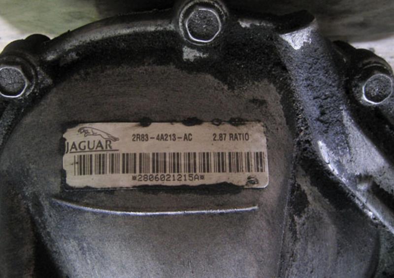

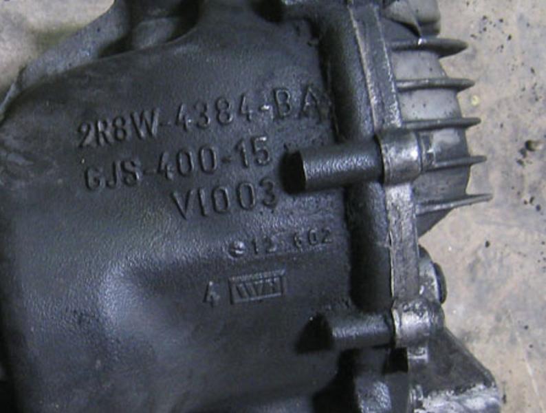

Eric of DTS called today. He contacted Ford and Jaguar. Ford gave him some info. but nothing from Jag. He needs info from differential cover. Is there any numbers, names, etc. Tomorrow I'm taking a pic of the differential cover. He said if it doesn't have Ford stamped on it, it may be a Dana rear. Of course he said if he had a carrier with him it would be easy to identify and likely fit a LSD. Eric also said one way to decipher wether Ford or Dana is to order a side seal of the carrier (where axles pass through). If it crosses as a Ford part then we have a Ford differential. He recommends a non-clutch differential, as the clutches will wear. If I soon put my STR up for the winter, I will have the indy Jag mechanic remove the differential and ship it to DTS. Any info guys?

Yes. See pictures below. They contain all the numbers from a 2003 STR.

Way to go tbird! Spoke to Eric (DTS). He'll visit this thread to garner the info. off tbirds differential. Again, the V6 and V8 use the same differential thus the same LSD. Stock ring and pinion must be retained for both.

No problem. The pictures are from a 2003 and I have a 2005 STR. But I can't find any differences other than the gear ratio for any S Type differential. Or Lincoln LS. The two cars have different ratios so if we ever get programming to allow us S Types to change the rear end gear we will have a 3.58 ratio option from the LS. This ratio on a STR would be a BIG improvement over the stock 2.87!

Spoke with Eric again. He said we have the same 8" Ford differential as the Lincoln LS, except our rear cover has cooling fins. He feels 95% that we can use the 8.8" Auburn, Traction-Lok, or Tru-Trac differentials, which he recommends over the other two due to its low cost and stronger build. The cost would be: $240 labor + $173 new bearings all around + $445 for the Tru-Trac differential= $859 plus tax. If four or more send their carriers he'll likely take off nearly $100. Wonder if we can purchase Tru-Trac for less than $445? Eric has the Lincoln LS carrier and is going to try to set it up as a LSD. This way we don't disassembal prior to definitely knowing this will work.
