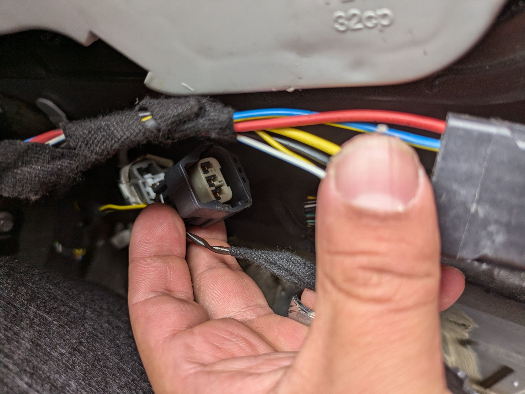

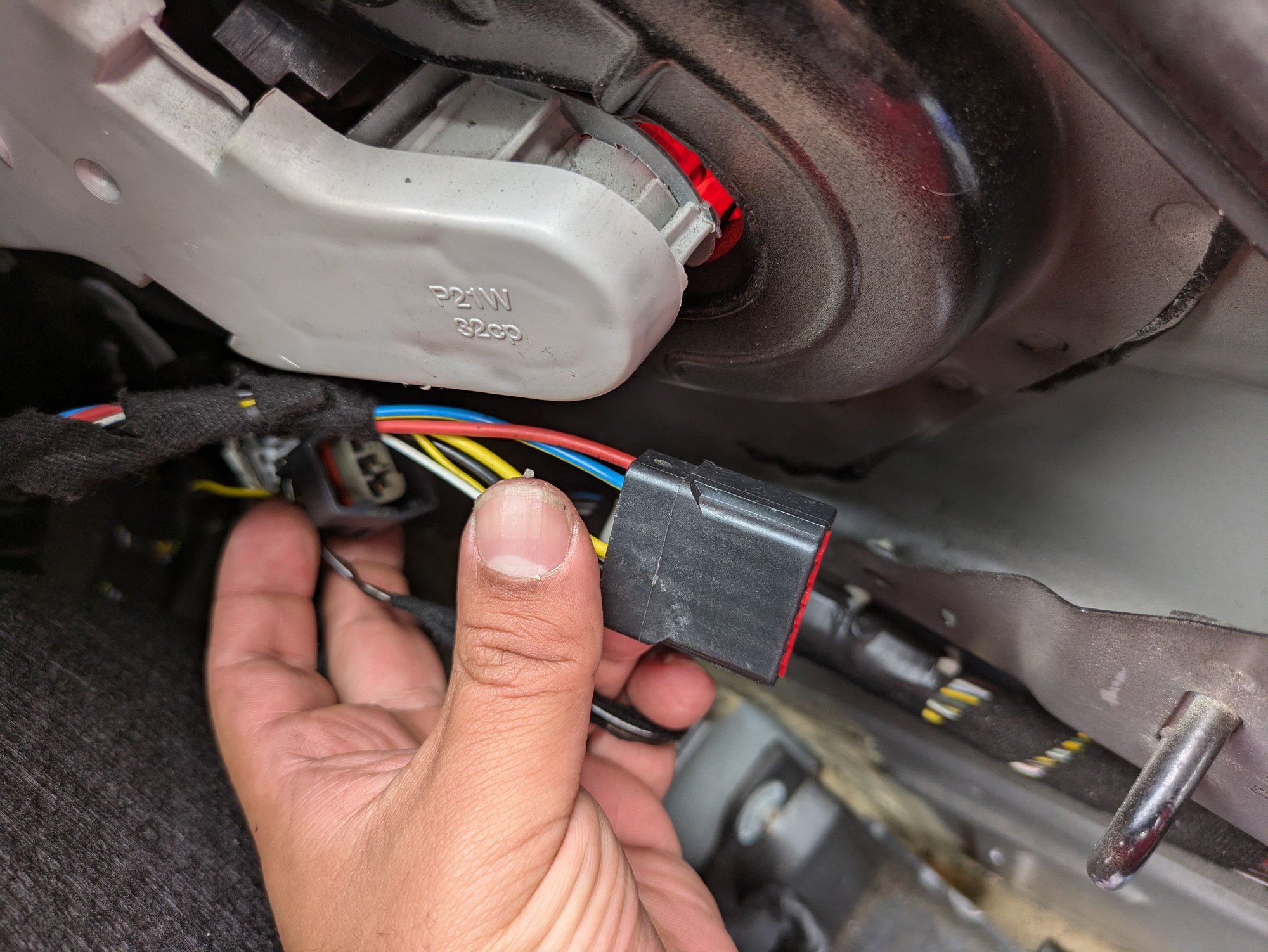

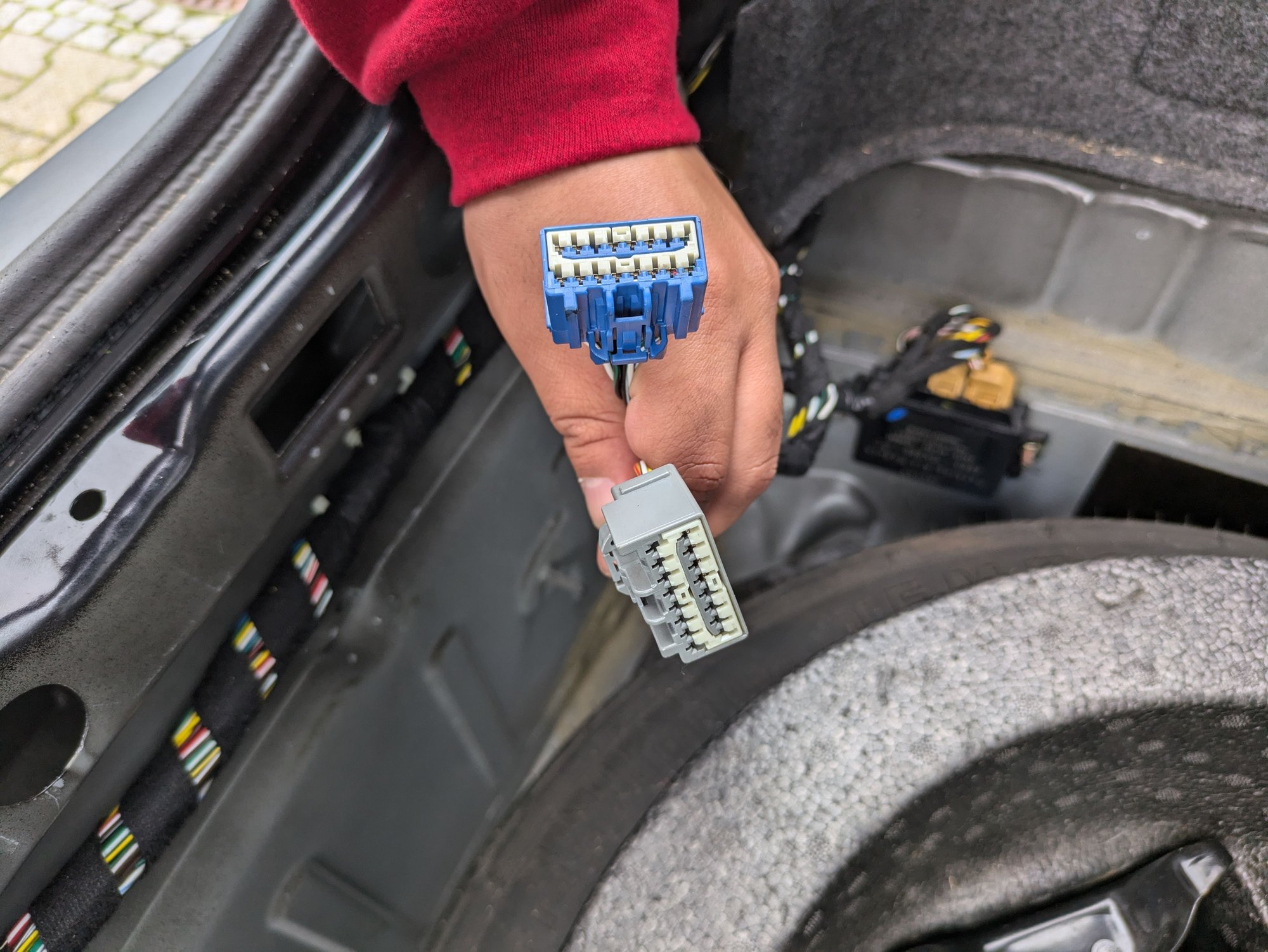

I am having an issue as well so I'm adding it on here. I haven't been driving the Jaguar long, but I was driving and thinking "man I got used to cameras and sensors, I kind of wish this car had them, then walked to the rear of the vehicle and noticed that there are in fact sensors.
I have a few cables that are not connected to anything (photos attached), which I believe may be the issue, but I don't see a connection point for them.

The pictures are nice, but you need to include the model year in your post as the color codes have been known to change from year to year. Also, if not originally equipped with sensors, the control module is most likely missing and the system electronics may need to be reconfigured to reflect the addition of this option...
Sorry for some reason I thought it was attached. 2005 Jaguar S-Type Base 3.0L 6cyl
