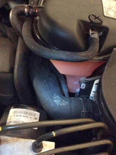

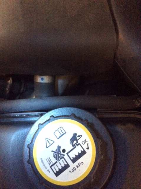

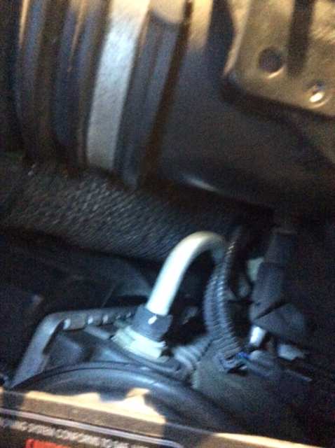

Default ? Location of Thermostat Jag S-type R 4.2 V8 2004 ?
I should receive an infrared thermometer today to check if sensor is correct or not, and temps around the radiator, thermostat in/out etc.
Forgive my many (due to inexperience) questions please. I have tried to look up diagrams on the web, but they are not always specific.
Please could you tell me where the thermostat is located - right or left of radiator as we look, and position? Is it accessible:visible or do I have to remove any covers.
See pics below.
To the left of he radiator, under the (full of orange coolant) tank there is the large pipe - is this in or out please? I'll call it Pipe1
*when cold this pipe squeezes easily! I assume it should be leess squeezable when hot and pressurised?
On the right side there is a metal pipe entering the top right rear of the radiator - what is this one? I'll call it Pipe2
In the centre, just behind the filler cap, there is a hose with a metal clamp which seems to go to the engine block, is this relevant? Pipe 3
Where else should I check the temps?
Thank you all for your ongoing help in trying to save my lovely car from leaving us!
See pics below.
*when cold this pipe squeezes easily! I assume it should be less squeezable when hot and pressurised?
pipe 1 is your top radiator hose .and it should definitely become hard with coolant pressure .
pipe 2 is one of your trans cooler pipes .
pipe 3 is no concern it's intercooler related .
test the alloy coolant manifold as the sensor is mounted at the back side of it .!
location of the thermostat is under the j pipe , the intake j pipe that goes from your air filter box to the oval alloy pipe in the center of your engine ,
so remove the plastic engine cover
then remove the plastic j-pipe .
and under there is an alloy coolant manifold with three t25 bolts holding the thermostat cover on . also it has the lower radiator hose attached to it .
heres whats under there .

Thanks Datsports - it's 10.30 am here in France, and I am now going down to the garage to do the temp tests
