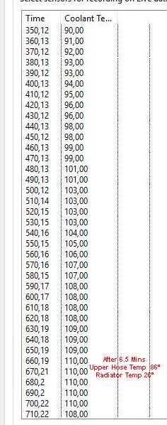

Thanks for advice above
I took the car round the block - it was slightly warm from this morning.
I attach 2 pics of which the second is the more important.
I stopped at the temp shown by the Gendan/sensor at 110°C (230°F) so as not to cause any damage. The car gauge only showed 50%!
The fans were blowing, but the Input hose temp was 86°C (187°F)!
- and the radiator was still showing ambient temp at 26°C (79°F)
So I assume that there may be a sensor issue, since the thermostat has not opened (at 110°C with fans running) - and/or the thermostat is stuck?
Either way, as you guys say, the percentage golf shot is to change both sensor and thermostat!

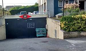

Since the potential "independent" garage had not inspired trust on the phone, and told me to phone again in a week to make an appointment, I had no choice but to use the local Jag dealer
*see photo of independent garage at 10.30 am last week
