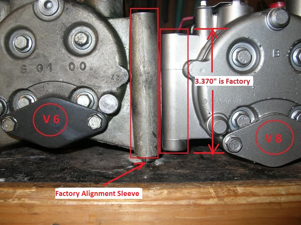

From what I had learned while changing out the compressor on a V6 is. The V6 bolt sleeves are longer by about a 1/2" or so than the V8 housing. The V6 is really easy to swap out but in regards to the V8, I have seen where alot more has to be disassembled because how much more room is taken up by the larger V8.
The V6 is on the left and the V8 on right:
I found this out the hard way, when the company shipped me the V8 version by mistake.

BTW in the picture in post #6, according to Brutal these are the "old" style compressors, the cover plate where I have "V6" and "V8" imprinted are not on the "new" style compressors, just a heads up!

I have now changed both A/C compressors out on my 2003 Lincoln LS and my 2005 STR for the same problem. They both were working great but developed a leak in the case and had yellow/green looking oil leaking from the bottom of the compressor. The compressor will last until the leak loses too much oil then the compressor will lock up spewing "Black Death" thru-out the system. You would be wise to replace it BEFORE the compressor locks up! You can do some internet searches to see the result of this Black Death!
The compressors from both cars are identical so we should have no problem getting a compressor for a good price. 2000-2008 4.2L N/A and S/C as well as the Lincoln 2000-2006 3.9L V-8 all take the same compressor.
Also wanted to point out that what JoycesJag said about the valve on the back side of the compressor. First this was where my STR was leaking from and I considered just opening that up and changing the O-ring. Second both new compressors came with the plate so I am not sure when they stopped including this valve?
The V-6 and V-8 engines have very similar compressors but use the correct one because the V-8's get a bigger compressor with 105 CC capacity compared to the smaller V-6 engines which get a 90 CC capacity version.
Using JoyesJag great picture I have labeled the mounting bracket width. I used DiscountACparts (AC Compressor, Condenser, Evaporator and More A/C Parts at Wholesale Prices - Discount AC Parts) and they had several errors in my order that could have been a disaster if I did not catch them! The S Type takes a PAG100 oil and they sent me PAG46. Big No-No! NEVER mix refrigerant oils!!
Second the compressor did fit but was NOT identical to the factory one. This is odd because I have my old Lincoln LS compressor and it's identical down to the numbers cast in the case of the compressor! The mounting bracket width was 3.580" compared to the factory 3.370" and the pulley was smaller too? Factory pulley is 12 9/16" in circumference and the one supplied was 11 7/8" in circumference. Plus the factory units had two small alignment sleeves in the top two holes to aid in installing the compressor correctly. The alignment sleeve is labeled in the picture.
But it was the weekend and I had no choice but to install it and see what happens? It did bolt up properly and the belt fit too. It's been about 3K miles and everything is working fine so it all worked out OK.
Here is the labeled picture.
I got the kit for $290 which had the compressor, the wrong oil, the O-ring kit and desiccant bag that came with the wrong plug. (Just reuse the factory Aluminum plug). Lots of errors but it all worked out OK. I purchased the correct PAG100 oil from AutoZone when I borrowed their free vacuum pump!
Attached Thumbnails S type R AC compressor leaking? Is this common?-c-compressor.jpg
