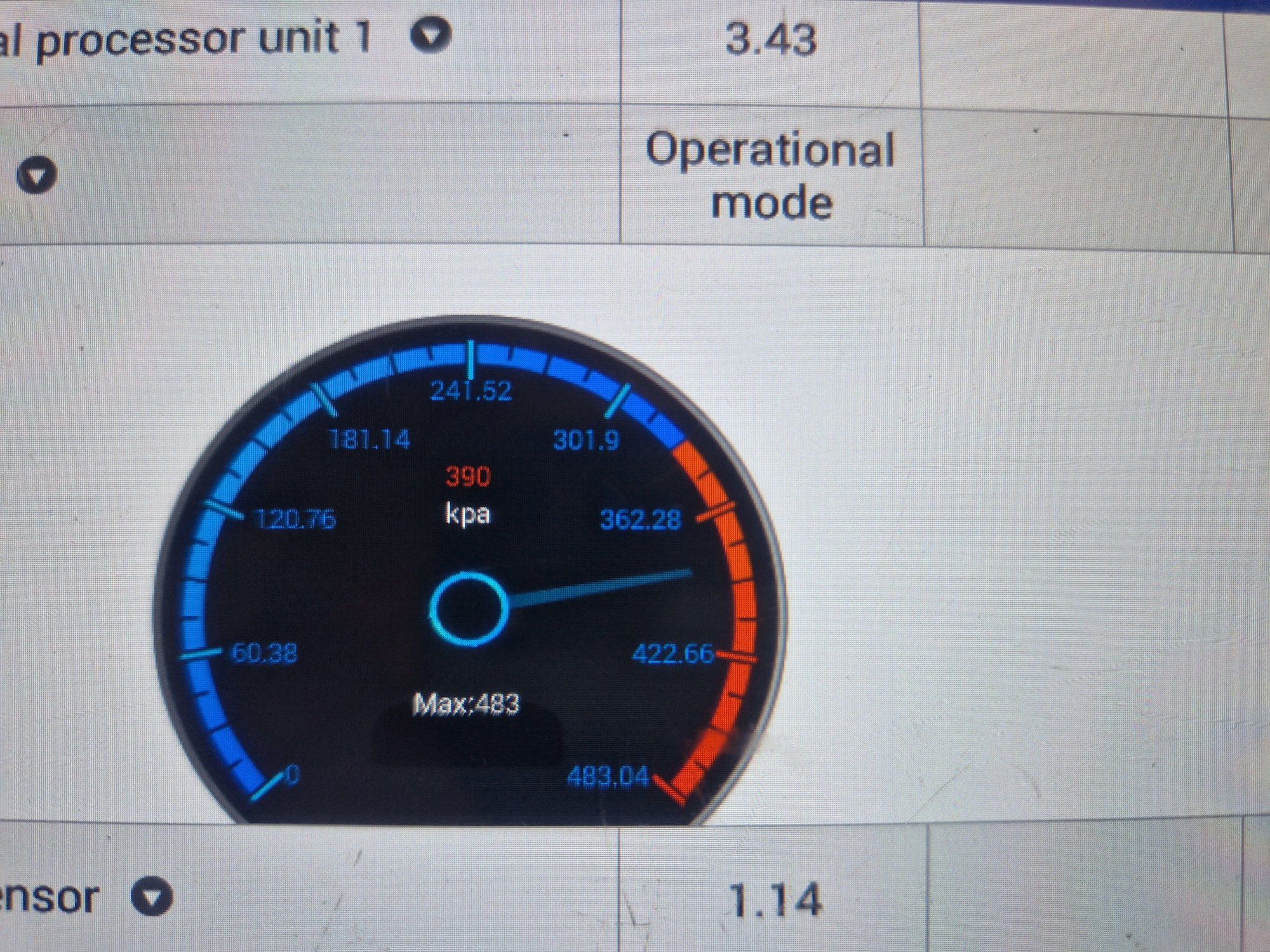

Supercharger back together diag measured in KPA so have 390 at idle and 483 at WOT which is 56psi and 70psi but this is smaller pulley, Mapped etc so should that be even higher? There is a horrible clanging noise from the supercharger still. Will create a YouTube link

I think your fuel pressure at 70 psi is your problem. It’s way too high and it’s probably dumping fuel into your cylinders causing it to bog out

There’s another problem if your scanner is reading 56 psi boost pressure your sensor that measures the pressure is not working correctly because there’s no way you can get that high even with a small pulley
70 psi fuel rail pressure at WOT is good.
This is fuel pressure not boost pressure
But I have found that I have no boost pressure according to diag, moving onto bypass valve and some other bits next to see what's up
OK sorry I guess I got confused when you were talking about the pressure in the supercharger in. My mistake but I still believe that 70 psi for a fuel pressure is much too high and they should maintain somewhere in the 55 range at high rpm or else you gonna be pushing fuel through the injector. There’s no reason to have a 70 psi fuel pressure at high Rpm because all you’re looking to do is maintain sufficient fuel volume for the RPM and you’ll get that at 55 psi I believe.

what do you mean by that? Are you going to post a log of the fuel pressure as you drive from idle to 5000 RPM? I’m telling you 70 psi fuel pressure is way too high! You can try whatever you want but I would focus on that 70 PSI.
By the way earlier in your post after mentioning 70 psi you said “but it has a small pulley. What does the small pulley”. what does the small pulley have to do with the fuel pressure?
What are your fuel trims at idle and at 2500 RPM?
please post a datalog showing the fuel pressure and boost pressure as you drive thru the rpm range. until I see your fuel pressure log from idle to 5000 RPM I’ve got nothing more to add.

The fuel pressure on the STR is boost referenced. What this means is that 70 psi is at full boost say 13 psi. So really the injectors are only seeing 57 psi. On my old 2005 STR (Same car) I had a fuel regulator failure and ran a manual fuel pressure gauge taped to the windshield for several weeks while troubleshooting and it read from around 45-70 psi depending on operating conditions. Just a note? If the car can't see the regulator the fuel pressure defaults to 70 psi (at least it did on my car). Ran fine but had a constant check engine light on with a fuel pressure regulator error code (P0193).
So just from those numbers it seems the fuel pressure is in the correct range and is changing based on boost. Now this all falls apart because you now say the car has zero boost? It should have almost no power if true? When I broke the SC belt on mine it ran fine and had no errors but man what a dog!
Can you do what Aarcuda suggested? We need to see boost and fuel pressure if possible.

Clubairth1 is on to something there , the raise in fuel pressure at the injector tip from 55-70 is cancelled out by boost .
hence the need for a fuel pressure increase in the first place .
but the fuel rail pressure sensor will show both target pressure points if all is well with the reg.
i believe the primary pump is (PWM) the secondary pump only turns on at WOT above a certain rpm . and just assists not PWM.
i had a fuel pressure reg go bad a couple of years back . it was lying to the ecm .
so the obd2 was reading a perfect 55-72psi but when i put a mechanical gauge on the schrader valve . it was actually reaching 110psi.
and cooked a pair of cats very quickly . so don't ,mess around getting this issue sorted .
you can do an up-stream back pressure test on the cats also if suspect .
