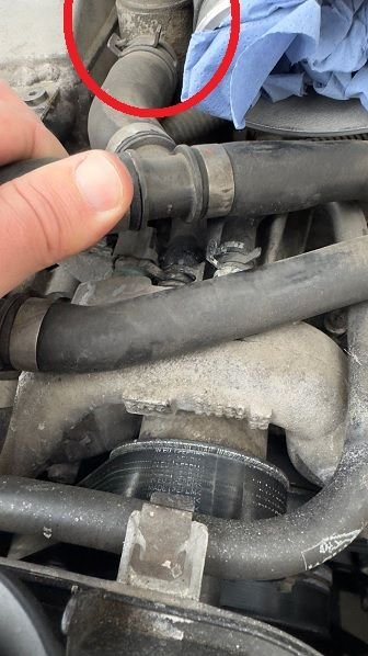

Hello,
Recently car has been losing a lot of coolant, luckly it's the return hose from the Heater Matrix (it leads all the way near the supercharger intake and then it lays somewhere behind the engine into the heater matrix i think) I think, the coolant lose is significant when the climate is on, either on cold or hot. I have been trying to find it but to no avail even looked up the diagram for the coolant hoses and only thing I could find was that it's position is near the the vent hose. Can somebody more skilled help me out to find the hose? I would had removed it myself but It's to complicated and it's pissing down here in Romania at the moment and I don't have a garage to pull it out and take the number from the hose itself. I will be posting photos with the banged up hose.
Thank you kindly!

this is the hose, it’s near a plug which I have no idea what it does.

I have circled it with red, tried finding it in JPART and SNG, to no luck. :/
Edit: Until the new hose arrived I was thinking to the hose after the cocked up part, and try to put it there with a garden clip so at least I can run the car around. At the moment my XF is in service for a timing kit change and I highly doubt I will be able to get soon. Is it risky? I will have to pull a little from the hose so It fits and it will be a bit streched out, can I expect suprises if I do this ímprovisation?

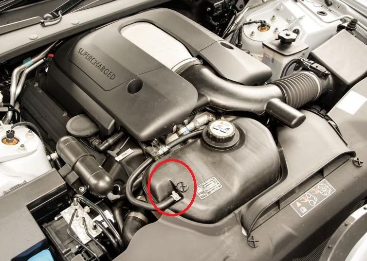

The port is to bleed the SC IC system of air.
Circled in red.

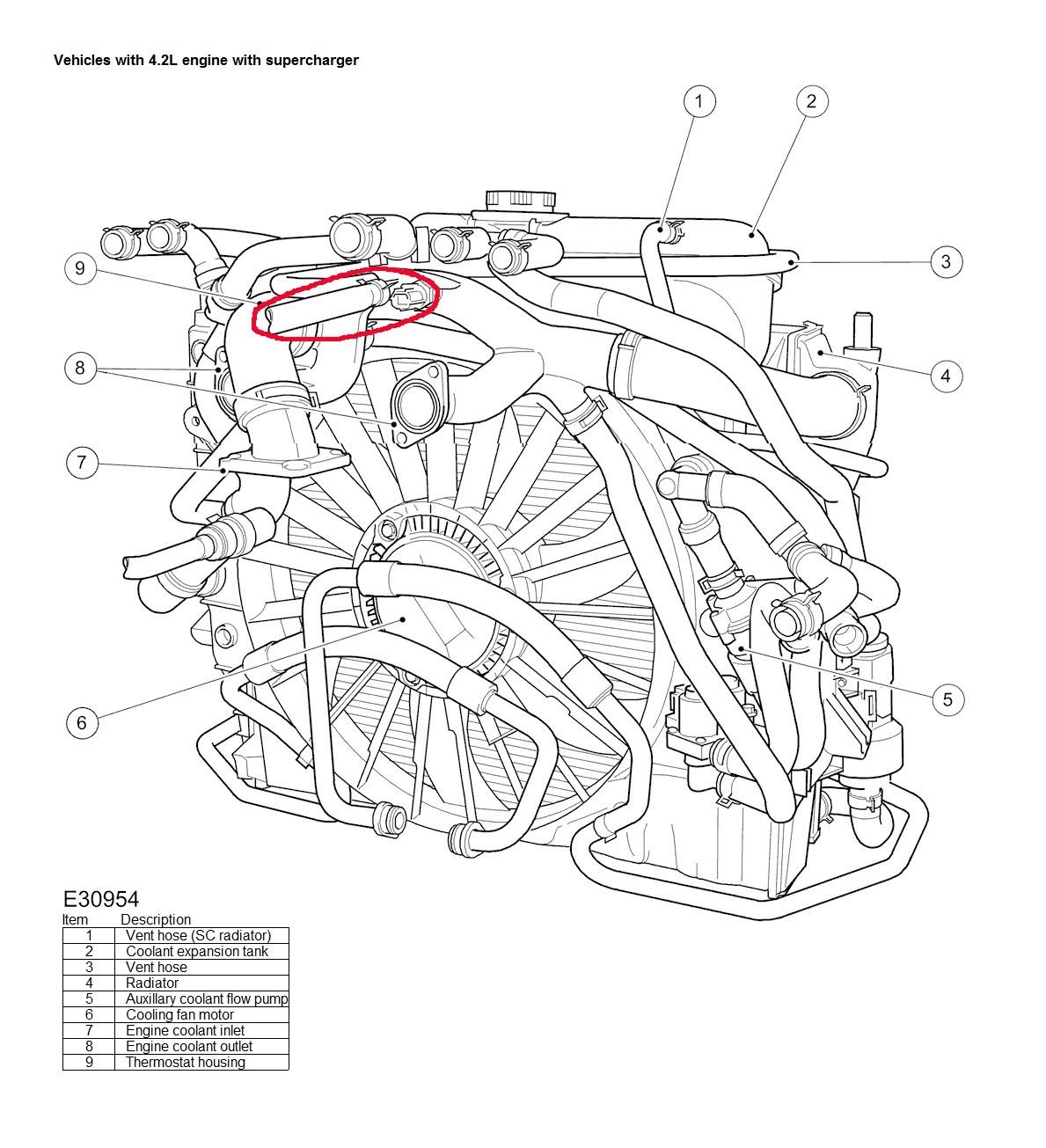

What you circled in red above is on the thermostat and I don't think that's the right hose.
Here is a much clearer picture I copied from one of threads listed below. Can you verify that I got the right hose as your picture is not too clear?

After looking at all that I "think" you need either XR841497 up to VIN N38936 or C2C26618 which has been superseded by C2C28125 after that VIN.
Again you did not post your VIN? Jaguar does everything by the last 6 digits of the VIN.
With a few searches it appears that C2C28125 has been discontinued.

My bad it’s not that hose I pulled it up sp it’s easier to spot the crocked one, the hose that went bad is right below near a plug on the left and on the right there is another hose, here is an image circled, the hoses that lead to the supercharger are in good condition.
tried removing it to see what part number it is, but to no avail. I will take it to my mechanic, but first and foremost I have to go there with the hose, no point trying adventures, it only leaks with climate turned on. Me thinks it might lesd into the heater matrix.

Anyway took to some research and with the help of Mr.Roel from SNG NL and before that I searched the entire internet for diagrams, it is a hose that is feeding the EGR Valve behind engine, it has nothing to do with the Heater Matrix. Main cause, old age. No aftermarket, only original, I suggest people to buy one you never know 2-5 days delivery time.
https://www.sngbarratt.com/English/#...J88507%60Water Outlet to EGR Valve Feed
Hose
Genuine ®
Brand: Jaguar
Product Code: AJ88507 part no. on hose 2W939Y438BC
€22.57 Inc BTW
I will come with pictures after I replace it, i truly hope this will help someone in the future!
