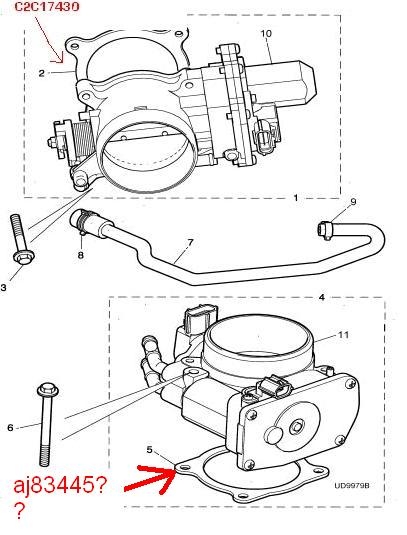

Throttle body hose. The SC V-8 uses the bottom TB the N/A V-8 uses the top one.
This is the dreaded hose under the SC!
Attached Thumbnails STR Coolant hoses-jaguar-s-type-throttle-body-diagram.jpg
