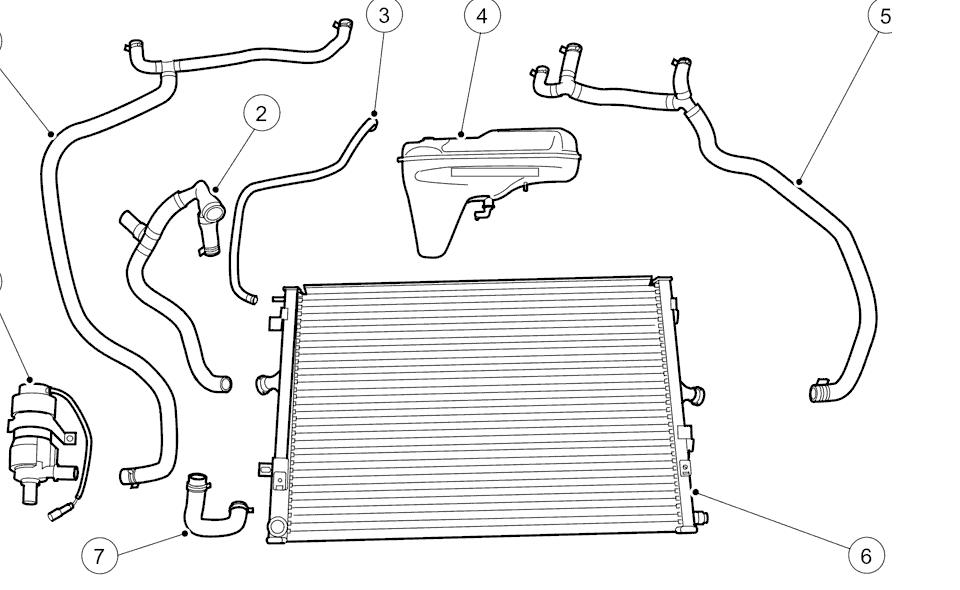

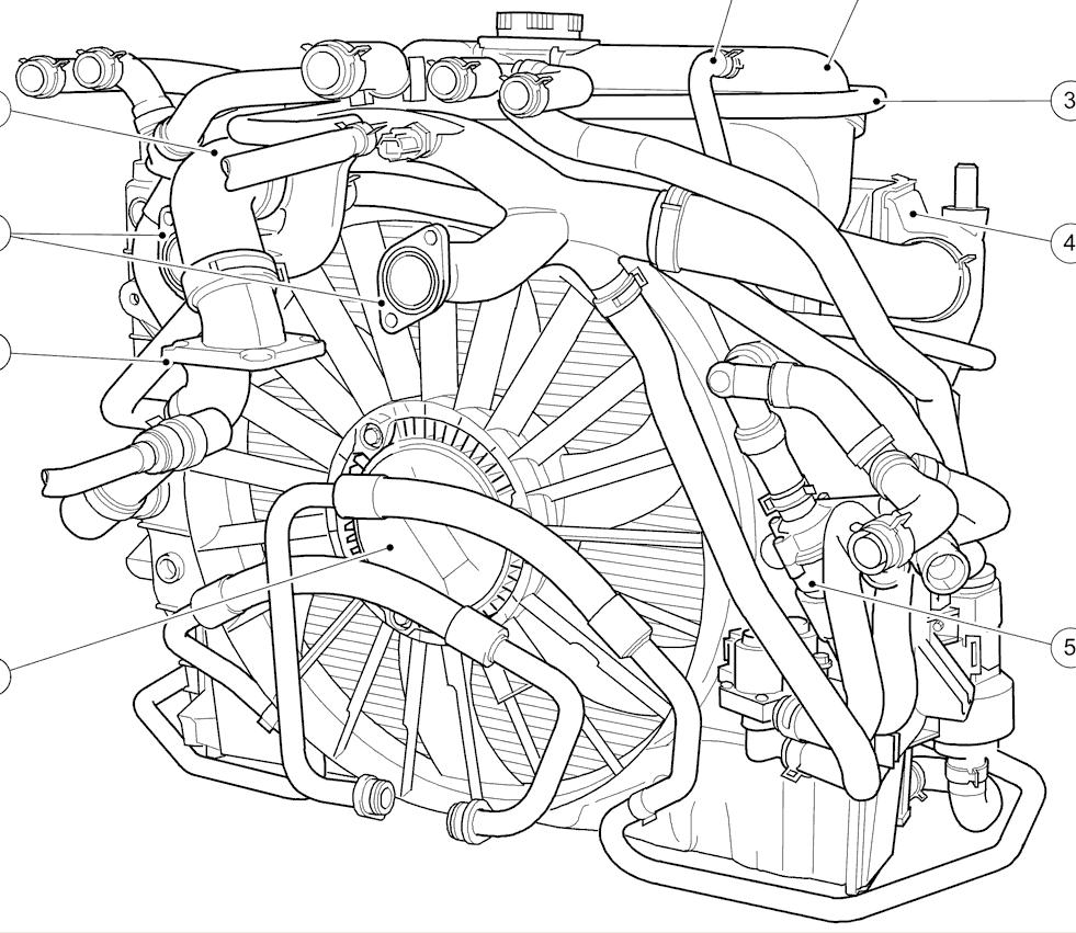

At least here is a picture of the cooling hoses on the STR.
And don't forget the SC Inter-cooler and all it's plumbing.
Oops! I almost forgot ! The EGR hose. Hard one to get to! I have that in stock ready to go. For us STR guys we only need #18 and #11 hose. #3 is the metal EGR tube that gets holes in it and #1 is the EGR valve and don't forget the two gaskets for it.

Thanks - not seen them all in one place before.
Oh... are the TB ones there?

Good catch JagV8!
I will post the throttle body diagram later. That hose is show in my top diagram but only the end at the front of the motor.

Anyone know what #4 is from the pictures? The big black plastic hunk coming from the radiator? Mine is cracked, I have plastic welded it, but it is leaking again after about 10,000 miles.
Seems like a huge pain to replace.
