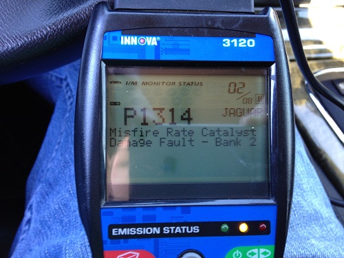

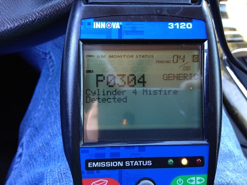

Fault Codes(In Order):
P0300
P1314
P0308
P0304
P0306
P0308
P1314
P1000

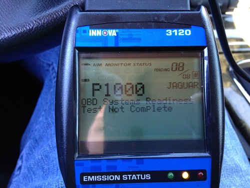

The P1000 is bad news unless you've very recently had the battery off or cleared the codes.

05BLKSTR, those codes seem to indicate some serious misfiring under load on bank 2. The P1314 doesn't mean a failed catalyst, it means bank 2 misfires serious enough to cause catalyst damage. Henceforth, the Restricted Performance message. I'm on-board with JagV8 about the coils. I'd consider swapping coils bank to bank and clear the system. Then see if you end up with P0301, P0303, P0305, P0307 and P1313 which means bank 1 catalyst damage. Easy enough to do.

I really think you have a catalytic converter going bad. The similarities to what your car is doing compared to what mine did is uncanny despite yours being an R and mine was a 3.0.
Or maybe it's time for a minor performance boost with some new high flow cats.. Tee Hee... I know others on here have done that...
The Jaguar tech that looked at the car pulled the plastic shroud off and pointed at the bank 2 intercooler gasket (it was covered in oil) and said there's your problem, which it wasn't...The car slightly (very slightly) surges while making a tapping sound resembling an ignition knock from bad gas. As for loss of power, While under heavy acceleration the car runs great / pulls hard until 4-5k RPM depending on the road grade.
Now that you have moved the ignition coils and the problem is still bank 2, that pretty much tells the tale. Your cats are still covered by the mandated 8/80 Emission Performance Warranty, I would make sure everything is stock and get it to your friendly dealer and have them assess the system.
