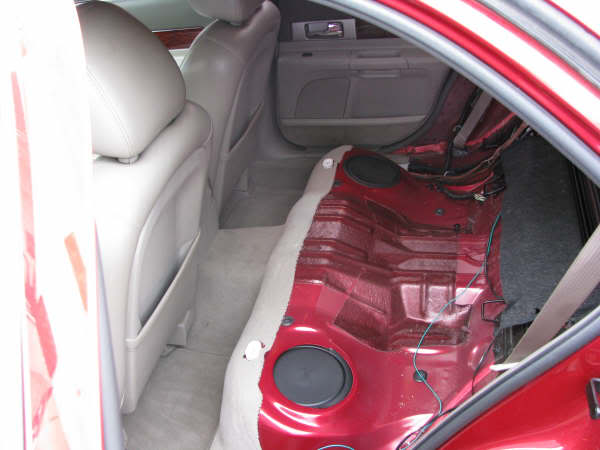

As was posted above Jaguar had the good sence to make getting at the pumps (You know you have two?) a bit easier than on older cars.
Here is what you are looking for. Some have called it a two seater out house! This is a Lincoln LS but it's the same floor pan.
The plastic covers and such are a bit odd so I would do some searches as people have figured it all out before. You might also check that the hose from the pump to the top fitting is good. Several people have found holes in the hose and it has been reported that the hose has fallen off too.
Attached Thumbnails S-Type won't start (coil pack diagnosis?)-lincoln-ls-fuel-pump-access-holes1.jpg

Yes, I've read there is a pump on both sides, but it's pretty unclear to me the role they play. It seems like most people who "replaced the fuel pump" replace the pump on the right side.
I actually already took the blue cap off the pump assembly on the right side, but saw it covered with fuel, so I thought I might just look into how much it would cost to have it done. Local shop returned a call with a quote for 540$. Unfortunately, they left a message and I need to get details on what that means. Right side only? Just the pump? Labor vs parts. They say they need to order the part, which is odd since auto zone 1 mile from the shop says they have it. Unless they are ordering an OEM part. I doubt it since I thought that part alone is $500+.
I may just be back to doing it myself. Hopefully I'll get on the phone with the shop tomorrow and sort it out.
