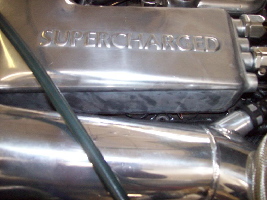

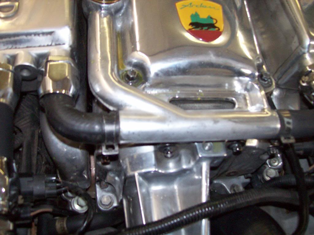

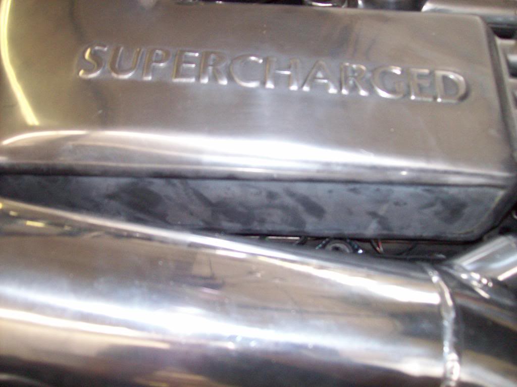

I have finally gotten the Killer chiller install to the point of running the engine, I am in total awe over the results. I have not yet driven the car, we have only had it running in the shop. I removed the heat exchanger in the front & had a tank made of aluminun, it is mounted to the bottom of the bumper beam. We ran the car for app 1/2 hour after 10 minutes the intercoolers were so cold you could see condensation on them, after 20 minutes the whole bumper beam was cold.

I hope to drive the car on friday morning, I will post results.
