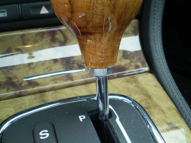

Take and wrap the chrome base in rubber or use rubber plier pads and grab it with pliers. It is only a lock nut but can be scratched. Then untwist the knob. Now, since your new knob has an emblem on it, you will want it facing a certain direction. I found that my custom knob would always loosen up. A trick I used on mine is to replace that chrome sleeve with a regular polished nut. I think it is 8mm bolt thread (but I really don't remember) but do know it is standard metric bolt thread so a nut is available at any big box hardware store. I threaded the nut down on the shifter then threaded my custom knob on. I then held the knob in the direction I wanted and used an open wrench to tighten the nut. My knob has stayed tight ever since.
You have a pic of this nut.
I got an STR shifter I basically almost destroyed cause it wouldn't screw down all the way, left about a 1/8" gap. Me being captain overtighten decided it just needed some coaxing to get the rest of the way on. So i cranked on it... Too much apparently lol.
Take care,
George
Sure.... First smoke break I'll take a picture and come back and edit this..
Just a regular metric hex nut...
