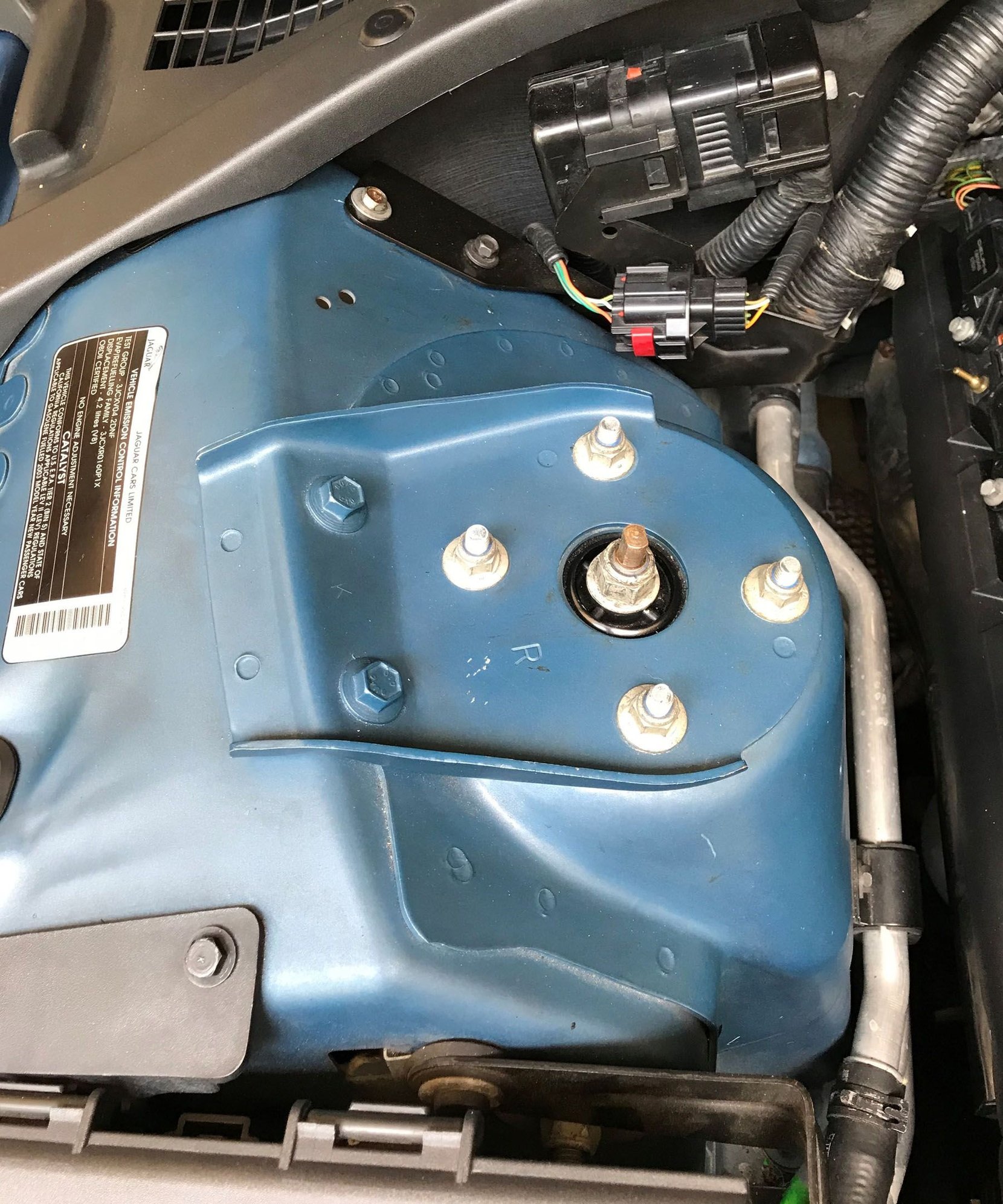

Does anyone know what type of shocks come standard on a 2006 Jaguar S Type 3.0 V6 base edition? I do not think they are the electronic damping control shocks, but I am not sure. I looked in the manual and I couldn't find out whether they are electronic damping control or without damping control. I would have to take off the wheel to get a better look at the shocks to see whether it has an electronic probe attached to it and I would prefer not to do that. Is there an easier way to find out what kind of shocks are on my car? Thanks.

The electric cats shocks have a plug in on top of the shock visible from above

Default Front shock absorber mount / not electric

No wires. Base shocks.
