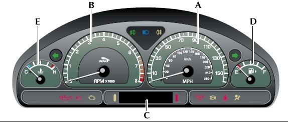

There's two levels of warning displayed next to the Odometer / Message Centre (arrowed 'C')
RED warning on the right is a Primary warning and must be investigated immediately. AMBER warning on the left is a Secondary warning not requiring immediate action.
The RED warning is usually accompanied by an additional warning light or further information displayed in the Message Centre regarding the reason it's displayed.
You really need to get hold of the Driver's Handbook which details all the message and the required action. Check this link:
https://www.jaguarforums.com/forum/s...ownload-10578/

Hey graham, do you see the bottom left panel with the check engine light and what appears to be the battery light? Its the left red one that looks like an oil lamp. I dont have any amber or red light, no error messages, only the cel which comes back to the o2 sensor and sometimes that lamp will come on. Thank you for the link!

That's the Oil Pressure Warning Light.
The correct operation is that it should be illuminated when the ignition is switched on and go out shortly after the engine starts. If it comes ON whilst the engine is running, this indicates a drop in oil pressure.
First thing to check is the oil level. If this is OK, then the sender unit or harness connection should be checked.
