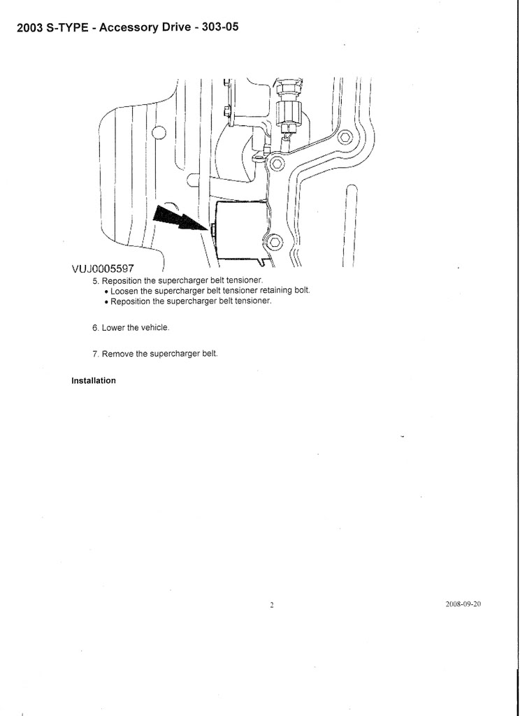

hey thanks for the link im gonna look when i get home and see how much i need to remove to intstall the new belt, it may be worth it for me to pay the $165.00, I have no problem changing brakes radiators blah blah blah ect. on other cars but im so scared of breaking a plastic clip or screwing up one of these headlights on this STR that i wont do it.

These pics and instructions might help in removing the supercharger belt.....
