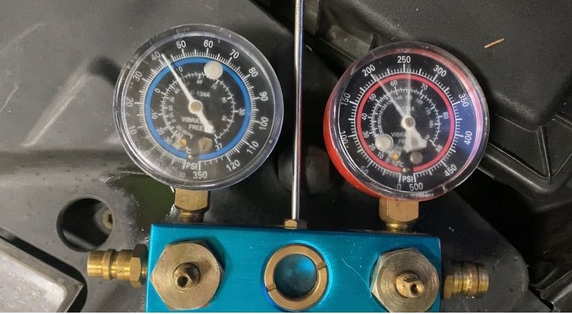

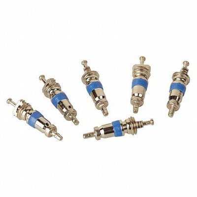

Even though the high and low pressure ports live a sheltered life it doesn’t mean they can’t go bad. I have 2 S types And I found that my low side port on one car was stuck closed and the High Side port was giving me a rapidly fluctuating Needle on the gauge set. when I went to replace the Schrader valve using a spare parts off my other S-type (which is a parts car) I remove both of those Schrader valves I need to find that one of the two was also stuck closed. So that’s two cars with two or potentially three bad Schrader valves

So that’s two cars with two or potentially three bad Schrader valves...
Right, but you're talking about the little removeable piece that threads inside the fitting, right?
Those little doohickeys are easily replaceable with the right tool. Some of those valves are oddball sizes, but should be readily available. But for the OP, his shop replaced the entire line. That would imply the fitting itself is damaged. That's the part leading the sheltered life, living under a plastic cap, and only touched every few years during an AC service. I suppose anything is possible, but it doesn't pass the sniff test.

the High Side port was giving me a rapidly fluctuating Needle on the gauge set...
Interesting. This goes along with my theory of a problem with the test gauge connection, with the expensive internal bits of the AC system way down on the list of likely culprits.

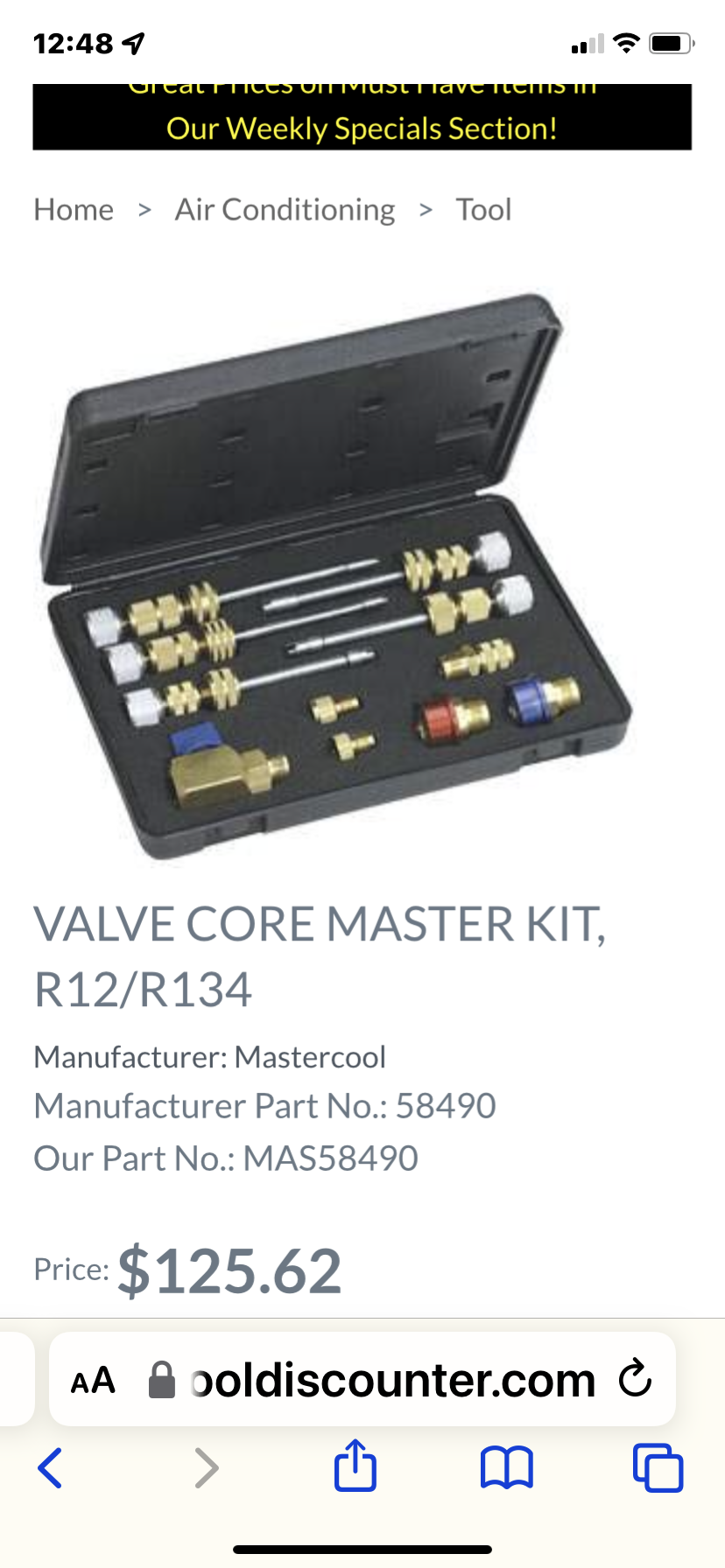

yes one would think that they would be readily available and easy to replace with the right tool but you’d be wrong. I have a very expensive valve core removal tool cost $125. Brand-name professional tool. The valve cores in these cars at least the S types are fatter And when they stick they stick in the closed position. And when they freeze up the stem doesn’t depress so the tool has a hard time grabbing the core to pull it out since the high side is in a vertical position so the core wants to fall back down when you try to remove it. they have a different thread positioning as well. . they freeze up. They are longer. The tool has a hard time grabbing them. they are just a smidgen too long to be removed with the valve core removal tool so you struggle with it. I managed to get them out by doubling up a bunch of O-rings to give me a little bit more room to pull the cord back out of the valve mechanism. Long story short it wasn’t easy very frustrating lost a lot of gas trying to mess with it. Oh yeah in the valve core, they were $20 apiece and special order
This is the tool I used
Here you can see the high side dancing. It stopped after I replaced the valve core

yes one would think that they would be readily available and easy to replace with the right tool but you’d be wrong...
I was following you okay up to the point where said I'd be the W word. I am absolutely not familiar with that concept.
I recently found the high side valve core was loose on my '02 V6. This valve core was a little bigger than the typical size you'd find on a bike or car.
I picked up one of these little puppies, a TLVC810 from CPS products, and was able to snug it down without any trouble. Amazon and eBay have them, maybe $10 or so. Might have been a different story if the valve core was stuck and I had to remove it, but I had no trouble tightening it.
https://www.cpsproducts.com/product-details/tlvc810/
