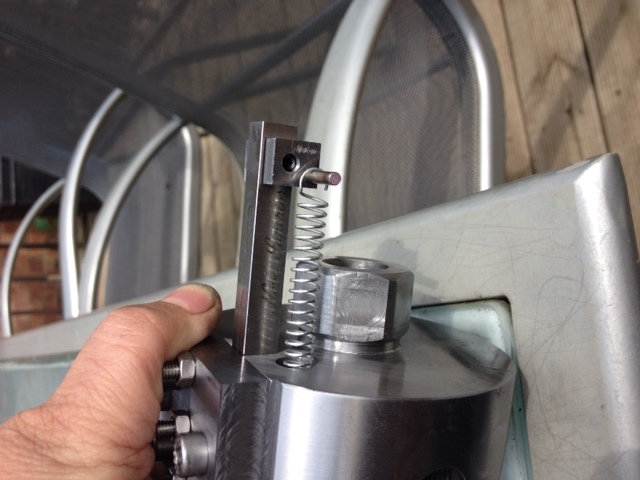

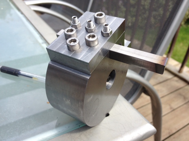

Ive made a few of these but this is the most over engineered one ive done so far.
not sure if pics will post.
if not al try again after a bit of coffee therapy.

Havn't got an electric drill so had to do it by hand.I machined a 32mm hex do drive with the socket.
The tool is radiused to reduce the stress risers.
I droped it off at Sheffield and did a complete snout in about 5mins.
No need to take the blowers off of the engines now to reduce the snout to fit the 10% pulleys.
