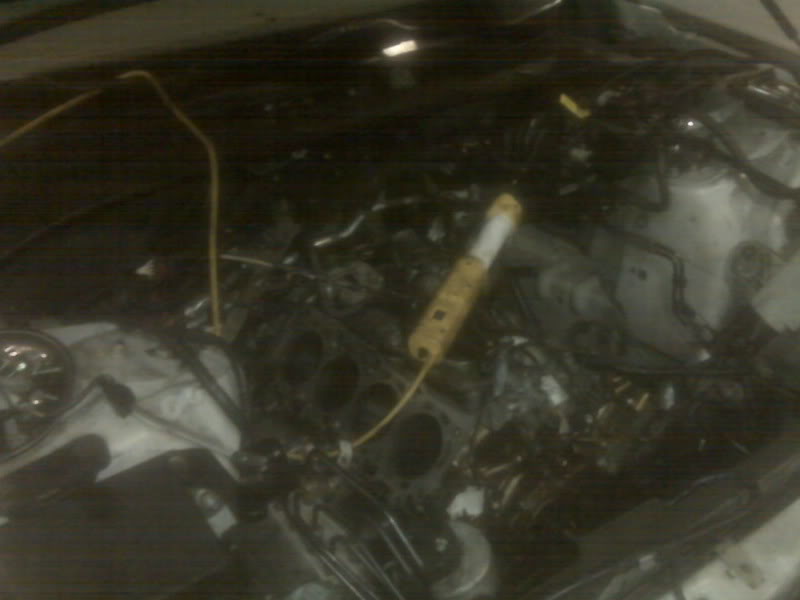

Old Feb 24, 2009 | 12:43 PM
fibercoat's Avatar
Joined: Feb 2009
Posts: 21

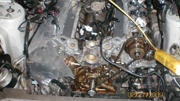

So the thermostat was the originating problem, water pump is fine but plastic and will r/r with the steel one. You have to love the price on new head bolts, Also have to love the torque specs. jeeesh. Everything checks ok... Now time to put it back together. Fun Stuff. I dont recommend personally just putting in a different engine.
When its said and done I know what I have and can rely on what I have by going through everything. Although my case is different than everyone elses. A fruit for thought though. If you have any overheating problem that is intermittent make sure you take care of it right away. For all these posts that said no heat coming from the heater... Thats how it started for me. Get it fixed and know its fixed right when it happens.

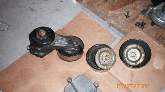

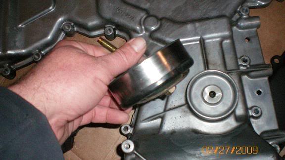

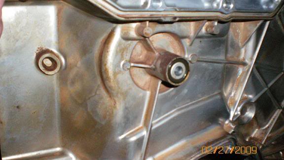

I feel your pain! Are you going to change the timing chain tensioners? I HIGHLY suggest you do. I had a picture of mine but don't know what I did with it. Anyways, the plastic tensioner cracked and I lost oil pressure and a timing chain! When they went to the new motor, they used the metal type. If you fix this, you will have fixed just about every problem the 4.0L has, other than the cylinder sleeves!
By the way, I have to ask you a favor, since you removed the timing cover, I wonder if you could help me with my problem! I need a pic or a description of the serpentine idler pulley that mounts on the passenger side, through the timing cover. Nobody seems to know the neccessary hardware and I am missing some parts so if you have it handy and don't mind helping out, I'd appreciate it!
Thanks! And good luck on your project!
Old Feb 27, 2009 | 01:10 PM
fibercoat's Avatar
Joined: Feb 2009
Posts: 21
Old Feb 27, 2009 | 01:12 PM
fibercoat's Avatar
Joined: Feb 2009
Posts: 21
Old Feb 27, 2009 | 01:13 PM
fibercoat's Avatar
Joined: Feb 2009
Posts: 21
Old Feb 27, 2009 | 01:14 PM
fibercoat's Avatar
Joined: Feb 2009
Posts: 21
