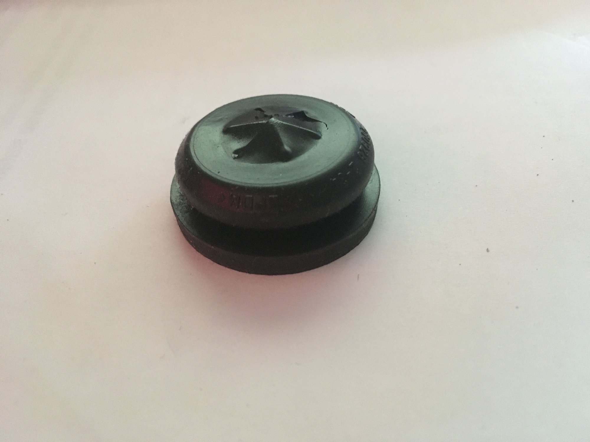

A new fault has appeared which may be relevant. At engine start, there is virtually no assistance from the servo. The brakes return to normal after 5-10 seconds. The same mechanic has investigated this and found a leak at a grommet in the vacuum line.

Said grommet cost was £4.50. A pleasant surprise. However, it was not available. The alternative was the complete pipe assembly - ~£45. Not quite so pleasant. But that was not available either. Solution - complete new servo assembly ~£600.

Photos'-
The offending grommet - broken
The connecting link.

I have found sources of similar items and have ordered one from AutoDoc (in Germany). The sizes look the same. My mechanic tells me that his net searches have revealed mine is not a unique problem. To aid others I will post the results on here once I find a part that suits. Another snippet he has come up with, is that a similar part failure has caused steering judder!

After a thrash round the lanes, my mechanic found a hot N/S disc and the attached wheel very stiff to turn. He changed the calliper and fitted the grommet.
To date, the judder has not returned. Still difficult to understand the intermittent nature.
