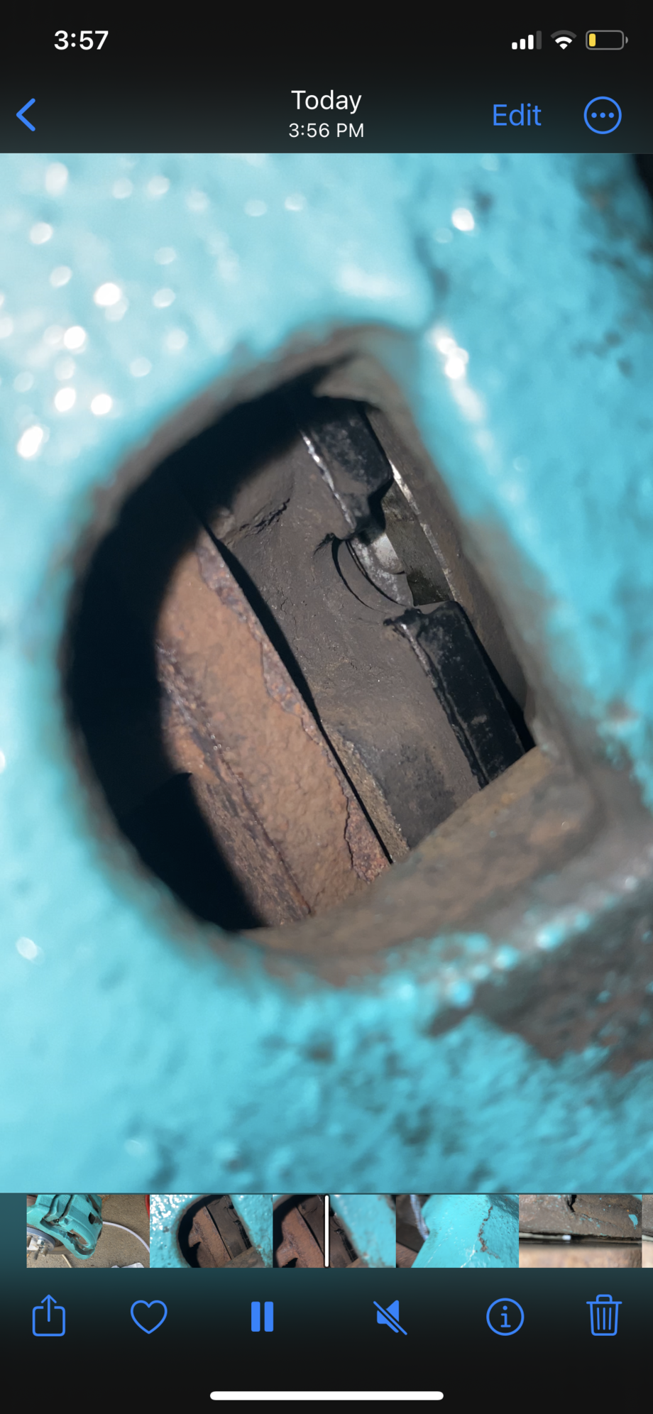

Piston seems parallel and straight
See how the disk is polished by its center?
See how the outter edge of the pad doesn't get contact (upper view)
See the same thing (exterior view)
I took pictures today.
everything is cleaned, piston seems straight
pads and rotors are surfaced perfectly.
both calipers do the same thing
old pads had diagonal wear... si clearly something is off

What brand of pads are you using?
I can think of five possible reasons for this:
1. You’re looking at this when the wheel is off and the disc has no securing screws installed, causing it to move at an angle.
2. Incorrectly installed springs in the calliper hangars or rust behind them pushing them out of line.
3. Poorly manufactured pads.
4. Poorly manufactured discs.
5. One of the sliding pistons is seized (assuming your brakes are of the sliding piston type and not opposing pistons).

awesome points.
i personally was convinced it was the rotor that's not tight, but then i remembered i have spacers installed so they keep the disk tight, haha.
caliper springs and pistons are perfect, i used a digital measuring caliper to check all the distances and they are good.
Pads and disks were new but they sat a long time on standby, so i had them resurfaced and measured with a caliper and they are perfectly flat.
i must send ate an email.
maybe my textar pads are just stupid. I mean they dont even cover the whole disk area. But their part number matches these calipers and they fit right in the slots.
i am wondering if the calipers have settings in regards to the pads-rotors gaps

I’ve never heard of Textar. I wonder if that is the problem.
I would suggest trying a quality brand. EBC are, in my experience, the best value for money (you don’t need to opt for the gimmicky sintered green stuff or red stuff. Their standard ones are best). Mintex are ok. Lucas TRW are ok. Blueprint are ok. Delphi are another good one as are Bosch.
AVOID Ferodo! They are poor quality these days.
When buying brake components, always go for quality stuff. It is a false economy to buy the cheapest discs and pads because they either warp, squeal, or don’t fit or work well. Also make sure they are the right part listed for your car.
One other thing to check: some pads have a raised locating blob on the back. These are designed to fit on the opposite side to the piston. The ones on the piston side have no blob. If you have installed them the wrong side the blob can cause uneven pressure.
Did you check both the sliding pistons move freely?

Yep, I wouldn't worry about Textar quality, it is the top brand from TMD in Europe above Pagid and the budget Mintex, and an OEM for many car manufacturers. Ferodo is part of Federal-Mogul and they are producing some very good high-friction road pads these days, along with their sister brand Jurid. I have the Jaguar/Jurid 233 pads up front and Ferodos on the rears. Best road combination for the Lucas brakes on the older S-Types I have yet come across.
However, for the later S-Types with the ATE brakes, they are single piston types, right? I would make sure that every moving part moves freely, including the piston itself. A sticky piston could well cause the problems you describe, allowing the pad to drag more than it should.
