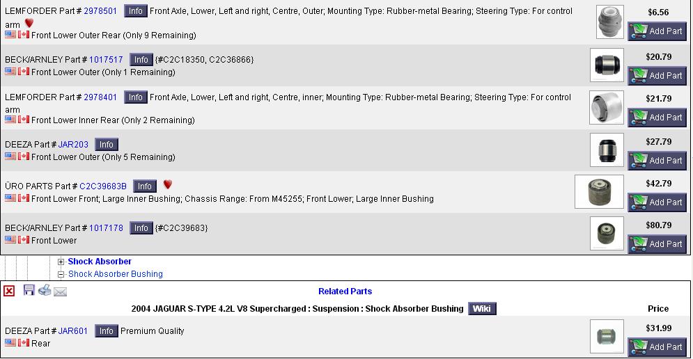

Found some blown bushings in my STR's front end yesterday, wondering if anyone happens to know if replacements can be sourced,
There are some listed on rockauto, but by the descriptions, as you can see, are very difficult to gauge which are which, as well as concern that some of these might be for 99-02 s-type applications...?
Anyhow, here's what I found blown,

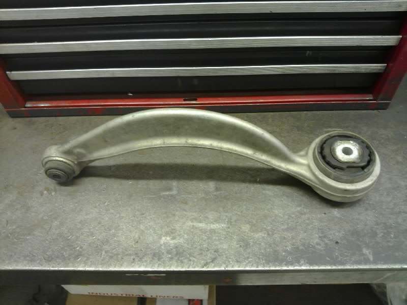

On this lower wishbone, the smaller bushing for the shock mount is blown, edit: i suspect this may be the right bushing... BECK/ARNLEY Part # 1017517 {#C2C18350, C2C36866}
On this curved wishbone, both bushings are gone, edit: big bushing is ÜRO PARTS Part # C2C39683B, small bushing, not available, but likely not blown, edit2: small bushing does in fact seem worn with lots of play, trying to source one again...
Rock auto's available bushings...

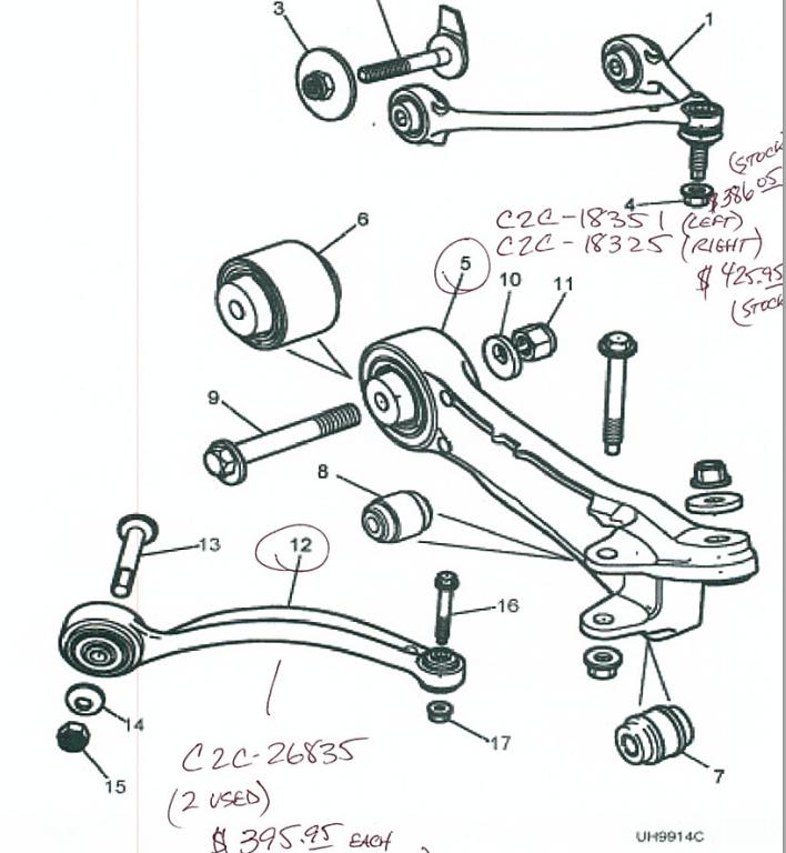

ok... well if i was to take a stab at it, here's what i think so far,
The second one on the rockauto listing there,
Looks to be for the lower strut mount... Does anyone happen to know if the CATS suspension/R-model cars had different strut bushings in the lower arm?
And the third last one, ÜRO PARTS Part # C2C39683B
looks to be the big hydro-filled bushing for the curved wishbone... which after some searching, confirmed it, also, the smaller bushing in that curved arm, doesn't seem to be available, but according to a post by brutal, he has never seen one go bad... so maybe skip that one,
Although I just stumbled across some threads regarding this topic on the diff jag forums... some reading to do there now too...

okay... well this may potentially be the right bushing for the front lower control arm, shock absorber mount,
Although, I am concerned about it being yet another 99-02 S-Type application being listed as working on an 03+, not to mention, the R cars or CATS equipped S-Type's might have a different bushing...? Don't think so though, as that lower control arm appears to be universal across the 03+ s-type and XJ range...

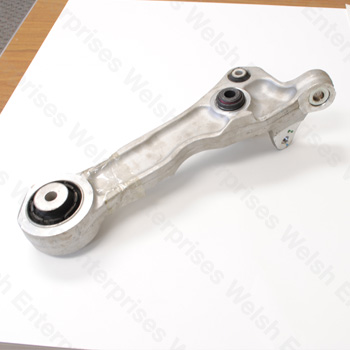

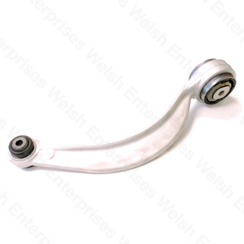

Apparently, all the front lower arms are the same across all 03+ S-Types,
heres a couple of pics that may be of use, looks like #8 is the right one, so I just ordered this one, BECK/ARNLEY Part # 1017517 {#C2C18350, C2C36866}
I'll let everyone know when the rockauto order comes in, and press out the old bushings and replace with the new ones, and confirm if these are in fact all the right components,

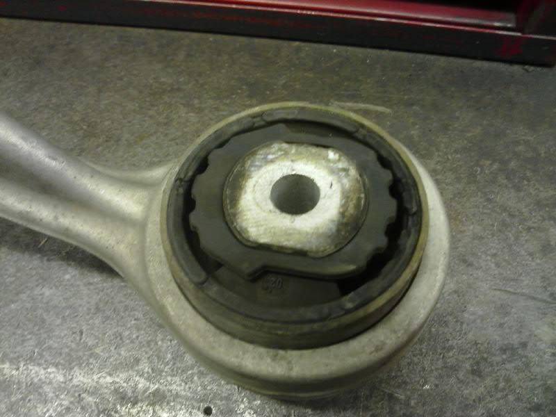

Originally Posted by TonyX
When you swap out the original bushing, C2C39683B, can you see if it's indeed hydraulic type? Thanks.
Hi,
Took the front end apart today on the STR,
The big bushing in the curved control arm, appears to be completely rubber. The replacement that came in, appears to be the fluid-filled / hydraulic type everyone talks about.
I'm guessing the STR cars got less compliant, more sporty, solid-rubber bushings, while all the other S-cars got the hydraulic type.
Regardless, I'll be replacing the STR rubber bushing with the hydraulic one, as it appears everything else is compatible, so not too concerned with it not being to the exact spec.
I'll be pressing in new bushings among other things tomorrow and have the STR back on the road soon to report on improvements/steering wheel shimmy fix...

so, here is the original arm,
original bushing, doesn't appear to the hydro,
replacement uro parts one, def looks like hydro inside the white plastic interior part there,
pressing the old bushing out,
I then gutted the original bushing, as the sleeve is very useful in helping press the new bushing back in, also gave me a chance to cut the guts of the original bushing in half in my bandsaw, and as you can see, looks totally metal and rubber in composition
and here it is getting pressed back in with the help of the sleeve,
Attached Thumbnails STR front end bushings...-05142013384-001.jpg   STR front end bushings...-05142013385-001.jpg   STR front end bushings...-05142013386-001.jpg   STR front end bushings...-05142013389-001.jpg   STR front end bushings...-05142013390-001.jpg

Theyre both hydro, the white piece comes out and is solid, so does the black piece on the factory one. The hydro part is what captures the inner metal bushing and the outer shell. And you did clock them correctly in the arm didnt you?

However, looking at the close up of your original bushing, how did you determined that they needed replacing? To my eyes I did not see anything that raised any red flags.
Again, thanks for taking the trouble to post your experience.

eh, appeared okay, but with a prybar check, it had way too much play in it, noticeably looser than the right side arm which was rock solid.
trying to track down some play in the suspension, so figure i would rule it out, and at $42 it doesn't hurt to replace it,
although I wish i could have replaced the smaller outer bushing on that arm as well, it doesn't appear to be available, and I also came across a post by brutal which said 'i've never seen them go bad' so figure its okay... guess i'll find out soon if a few new bushings and new lower ball joints fix the steering wheel shimmy issue i been having.
