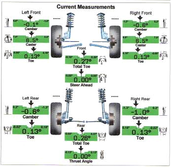

After two previous alignments set at 0.0 Total Toe-in during which a set of tires were badly worn on the inside front and back. I just installed a new set of tires and had the alignment done to reflect 0.26 Total Toe-in front and back to reflect the recommendation of Brutal.
We'll see how that works out...

yes the original factory setting caused too much inner tie wear so the toe in was increased. They should align it correctly(you have to pay) but keep in mind you need to talk to a tech. if the advisor is unaware of the changes cause they werent around then, or just dont know that would be his/her response. now if the whole service dept incl techs are unaware of the issue and the corrections(including having to still input the correct specs into the alignment machine even if the latest and greatest software is in, vcause its still wrong)
then run away.
Bull27 even with the correct specs I set the toe to the inside of the spec and then check deflection. and if there is too much deflection I have set cars into the red on a static alignment toe setting. See seaandranches pic, that alignment I have NO issue with and thats what mine would look like.
bacardi, no you shouldnt, if I did your alignment you wouldnt, you need to go and get that corrected.

Well here is what can go wrong if ya don't stand over the tech doing the alignment. I gave the tech a full sized copy of the alignment I posted above and went over it with him and insisted that no matter what the machine said that is what I wanted.
I left him to do his job. I also point out that my car was lowered and he would have to use blocks to shim the ramps on the lift. He agreed and complied. On and off smooth as silk. Once finished he took the car for a test drive. Upon his return he announced that it drove like a dream. I asked for the printout which he said he hadn't done so I insisted he go do it. He then produced the printout which was in degrees with the exception of the Toe-in which was in inches. He said it was exactly what I asked for so we went back and forth getting nowhere until I asked for the manager. He couldn't transpose so the manager asked me what he would like him to do. I said if ya can't produce the Toe-in in degrees put it back on the lift with the blocks and reset the machine to degrees and lets see what they are. Well guess what the front toe-in was .55 and rear toe-in was .44.
Do it over and I'm gonna stand here and make damn sure it's done the way I want it. Having done that I retreated to the office. The tech lowered the lift and neglected to put blocks in - tore up the passenger side rocker trim and dropped the front bumper and lower valance on the lift edge.
Get the manager as I'm about to smack the Tech and he asks me what would I like him to do about the damage which the Tech reluctantly admits to. I said look at the car what the f*ck do ya think I want ya to do about it. PAY TO GET IT FIXED.
I got a call from the body shop an hour ago should be on the street this afternoon. Rental car for three days and a repair bill of $2,000. The manager choked when I first showed him the estimate and I informed him the bumper was being removed, repaired and completely painted before re-assembly. He suggested his own body shop.
I calmly informed him "it's going to this specialty shop and this is not negotiable and additionally the bumper is being repaired and not replaced saving you money and if he argued anymore we were done talking - take responsibility and write the check either to me or the body shop - choose your poison".
In total this car has now had two previous alignments and two at this shop. A reputable shop I might add.
I also insisted that when they installed my new tires prior to the alignment to hand torque my wheels and re-torque my wheels after 300miles. I had the alignment done after the tire break-in.
Even when you are fussy sh*t happens...

lol damn, he didnt even have to change the machine specs really and thats why he screwed up the first time by taking it out of degrees. All you really have to do is go to the new spec toe in on the old spec screen. It will show its in the red under old specs for toe in but it will be correct. This is what i kept telling jaguar back in 03 when we were putting new tires on in front all the time when they had less than 12/12k on them. I looked at the tires and toed in more especially after racking the cars and seeing that according to the alignment specs they were in the green and fine,,,,but the tires say differantly. So i toed them into the red and they quit wearing the insides out. While others were still gettign their customers back with the same issue and looking for worn suspension or other issues. Finally jaguar changed the specs after we sent the enough reports

The main thing i want people to understand(other than "all" spec in alignment machines have incorrect toe specs, 2.5 my and up Stype) is that the shop should always check toe deflction after they set toe before they finallise and tighten everything up. Aka mercedes alignment with pressor bar,(push out with you hands evenly on the insde fronts of both front tires at the same time). This closely simulates what your tires and suspension do when youre driving. It also shows suspension issues you may have missed like bad tie rods, ball joints, wheel bearings, bushings, etc etc.
If they set to the middle or the outside of specs you can still have wornout inner tires because the tires "toe out" while driving. This is why i like a tight total toe of .26 there are even times ive had to toe into the red after checking deflection, but it gave even tire wear across the face of the tires.
