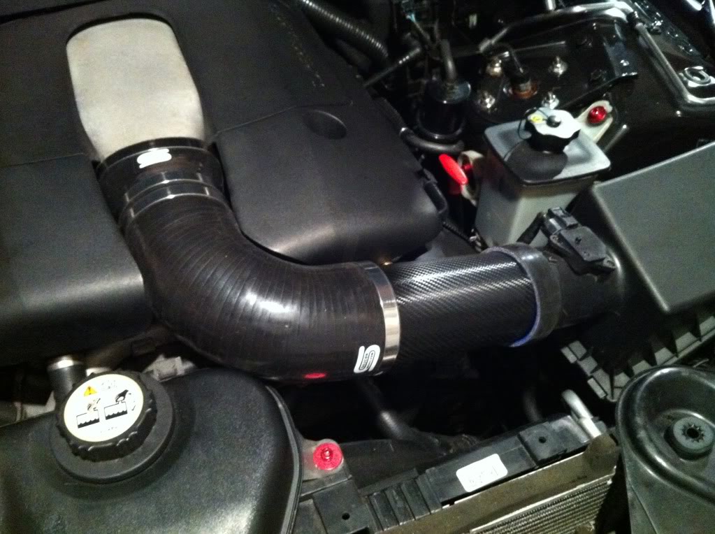

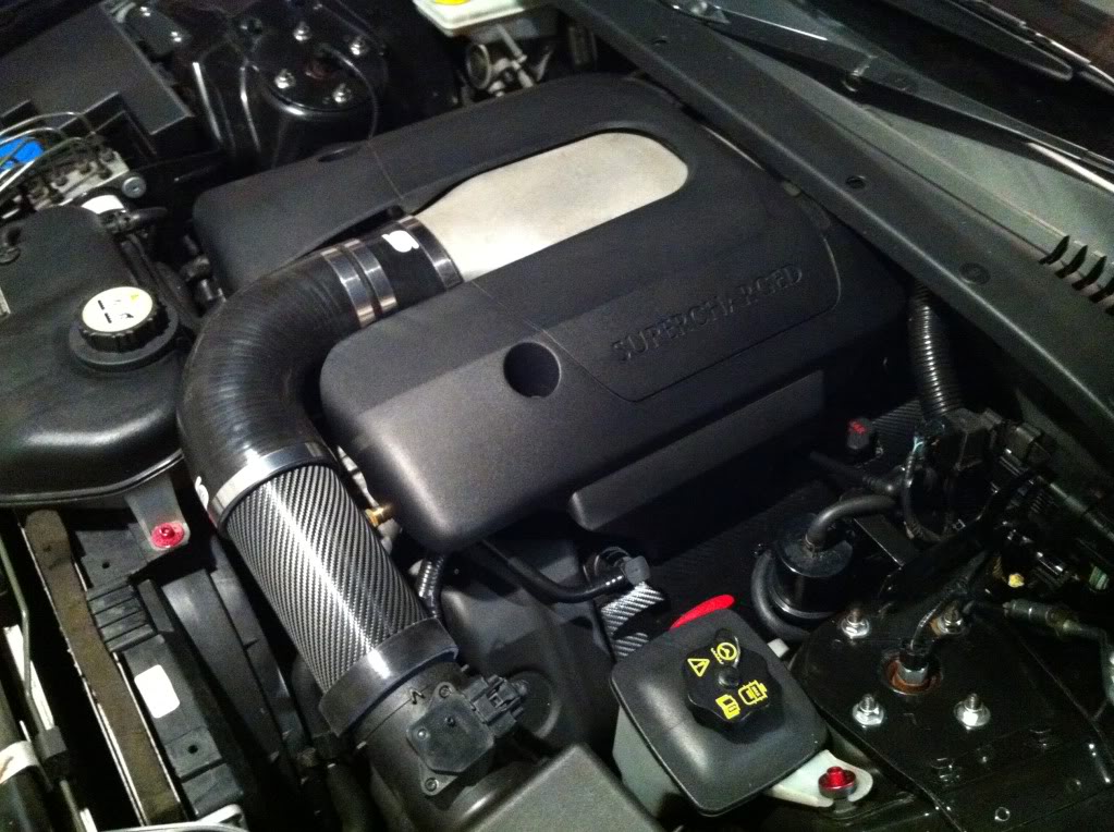

Read with interest a lot of thoughts on replacing the standard air intake elbow with a simplified tube version as it appears to give some performance benefits so had a go at my own today. Like to know what you think

Hey looks good. What material is it made out of?

Elbow is silicon onto aluminium tube with a carbon wrap
Remap was a pain Done by the guys that made the exhaust, it was initially locked down, but a contact of theirs ( Ex Jag development engineer) turned up and managed to remove the ecu security code causing the problem. Not run on the dyno yet but Im fitting water injection soon and will be set up on the dyno then Ill post some numbers as soon as possible

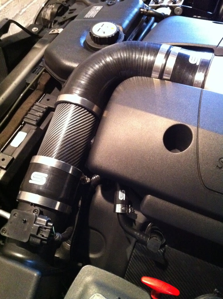

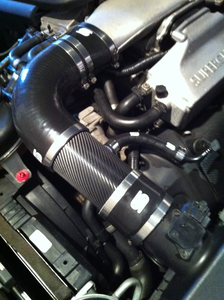

Pulley was from Phoenix as well Whos fitting it for you?. Would like to see Mafiosos intake elbow in the flesh it looks the real deal. Finished my version about 1/2 hour ago

I'm seriously hedging on sending the s/c, throttle body, pulley to Stiegiermeir for port/polish/pulley fitting. Just threw an e-mail to Bob S. for price quotes and feed back. Due to weather I'm not going to use the car for another month and a half, so this is the time to do it. Your intake elbow looks functional and professional. R U gunna dyno her? Phoenix Coach Works said their pulley with a full exhaust mod should give a 8% increase or around 440+ hp. Did you have to grind down the blower snout?

Same here Not going on the road for a few weeks yet Yes I had to grind the snout but with the guide phoenix supply its a pretty straight forward thing.
