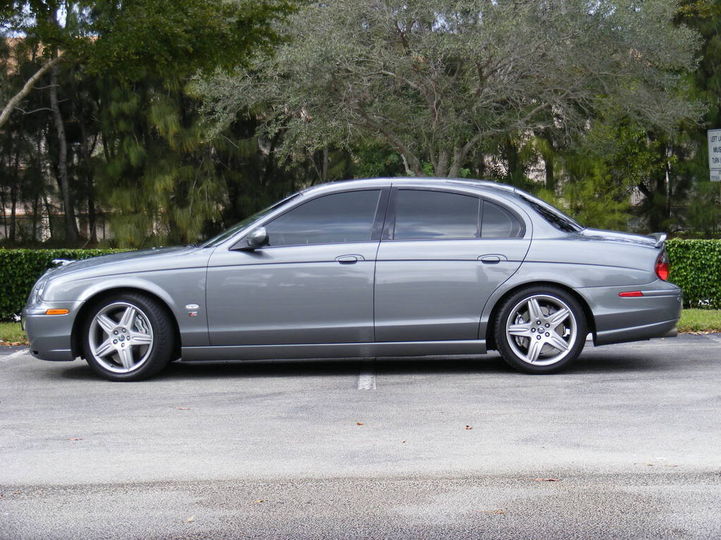

I'll take pictures for you tomorrow and post them. Now my car is about 1.5 inches lower at the front and 1.25 inches lower at the back. What I noticed in your pictures is that it seems like the back is actually lower then the front, is this the case or am I mistaken?

I also have the mina gallery springs on my STR. I have not heard any noises after the drop. I also do notice that the rear seems a little lower than the front.
