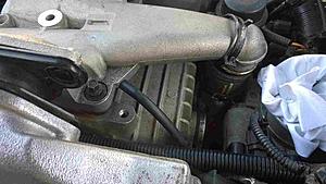

Hi, I have a 2003 STR and this vacuum hose came loose on the other side and I can't find what it attaches to. Any help would be greatly appreciated.

It attaches to a black square thing (don't know the technical term, think it has something to do with fuel) which would be just out of the picture in the bottom right corner, should be an elbow at the end of the hose going to black square thing. I have my wife's STR torn down at the moment for a full hose replacement, valve covers, new EGR pipe/valve, supercharger rebuild, and a bunch of other stuff. I can take a pic if you need in a few days, not really working on it at the moment, you know, Christmas and all!

Winter JAG is correct. It attaches to the fuel pressure sensor. To the right side behind your intercooler
looks like this although it would be hard to see.
let us know if you find it!

Thanks everyone, I was able to reattach the hose.
