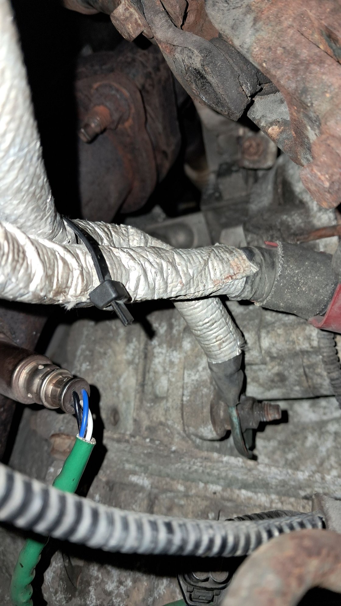

Got the car up on the ramp and removed the undertray, according to 'Topix' the starter motor on the V8 is only held on by two 'bolts' (they actually appear to be nuts ?)
The V6 and diesel models are different.
Bottom nut is clearly visible, it has a second nut attached that secures the earth lead.
The top nut cannot be seen using any method that I have at my disposal.
I can reach in and feel it, it's a 13 mm, but trying to get anything on it to loosen it is proving to be very awkward.
Managed to get an 'S' shaped spanner onto it and managed to move it by a fraction but can't seem to get any of my 13 mm ratchet spanners onto it.
Has anyone tackled this job who can provide any hints or tips ?

Old Apr 12, 2025 | 07:32 PM
kr98664's Avatar
Posts: 4,925
Likes: 2,324
From: Oregon
Originally Posted by The Voices
the starter motor on the V8 is only held on by two 'bolts' (they actually appear to be nuts ?...
I can reach in and feel it, it's a 13 mm, but trying to get anything on it to loosen it is proving to be very awkward...
Please see the video in post #10 above. The guy had quite the battle getting that upper fastener removed. He posted some specific details showing what finally worked.
He also said the fasteners were an oddball design that looked like a stud and nut. Instead, it was a one-piece style like this:

Old Apr 26, 2025 | 03:44 PM
  #35
The Voices's Avatar
Joined: Jul 2016
Posts: 74
Likes: 22
From: Nelson, Lancashire
Finally managed to get time to fit the new starter today.
No idea why I bothered, as ironically the car has started first time, every time for the last 2 weeks !
I can honestly say that extricating the top 'hidden' bolt is one of the most stressful car maintenance jobs that I have ever undertaken.
It is a 13 mm headed bolt, not a 'stud / nut' like the lower one.
Access is absolutely awful, you cannot even see it to get a spanner / socket on it.
I managed to get about another half turn using an 's' shaped obstruction spanner and then after dozens of attempts, got a 13 mm 1/4 drive socket on it by attaching it to a 150 mm extension and a universal joint to clear the engine mounting.
You have to basically feed the extension in down the side of the starter motor and then try to guide the socket onto the bolt head.
I was then lucky enough to be able to undo it with another long 1/4 extension connected to the universal joint.
So far, so good..................................
Then actually getting the starter motor out of the gap is another excercise in frustration.
You have to twist and turn it at every angle imaginable to avoid damaging the oxygen sensor wires on the catalytic converter.
Of course everything has sharp edges, wearing nitrile gloves is a waste of time, as they either split almost instantly or get cut to ribbons.
My hands look like I have been attacked by angry cats.
Once removed, you have to repeat the same process to get the new one back in place.
The bottom stud is easy to get back in but the top bolt was hell on earth.
Once again working blind and mostly by 'feel', it must have taken 30 attempts to get the bolt and the extension assembly into place, as there is no room to 'start' the bolt into the hole by hand.
Using the same combination of extensions and the flexible joint allowed me to tighten it up for several turns, but it then became almost impossible.
The bolt is approximately 50 mm long, so needs a lot of turns to get it tight enough to do the job.
At this stage I was worried that I had managed to cross thread it, so had to call on the assistance of one of our technicians, who was doubt muttering 'bloody amateurs' under his breath.
He kindly had a look and had to undo the bolt to be able to check for any damage to the threads.
Again, by a stroke of luck, the threads weren't damaged.
He then had as much trouble as me trying to get the bolt / extension assembly back into place, when he did, the same problem occurred, seemed to be tightening up well, and then became very hard to turn.
Only thing we could think was that the universal joint was now binding against the starter body as the bolt tightened.
This resulted in him raiding everyones toolbox to try to find a different universal joint or alternative extension / socket combination.
A different joint and a longer handled 1/4 ratchet allowed him to finally tighten the bolt, with much colourful language when he had to hold everything in place whilst one of the other technicians had to find an alternative ratchet to the first one he tried.
I then finished up connecting the cables and made sure it would still start before refitting the undertray.
Still starting first time, so no idea whether the new started has fixed anything or whether the fault has just 'gone to ground' for a while ?
