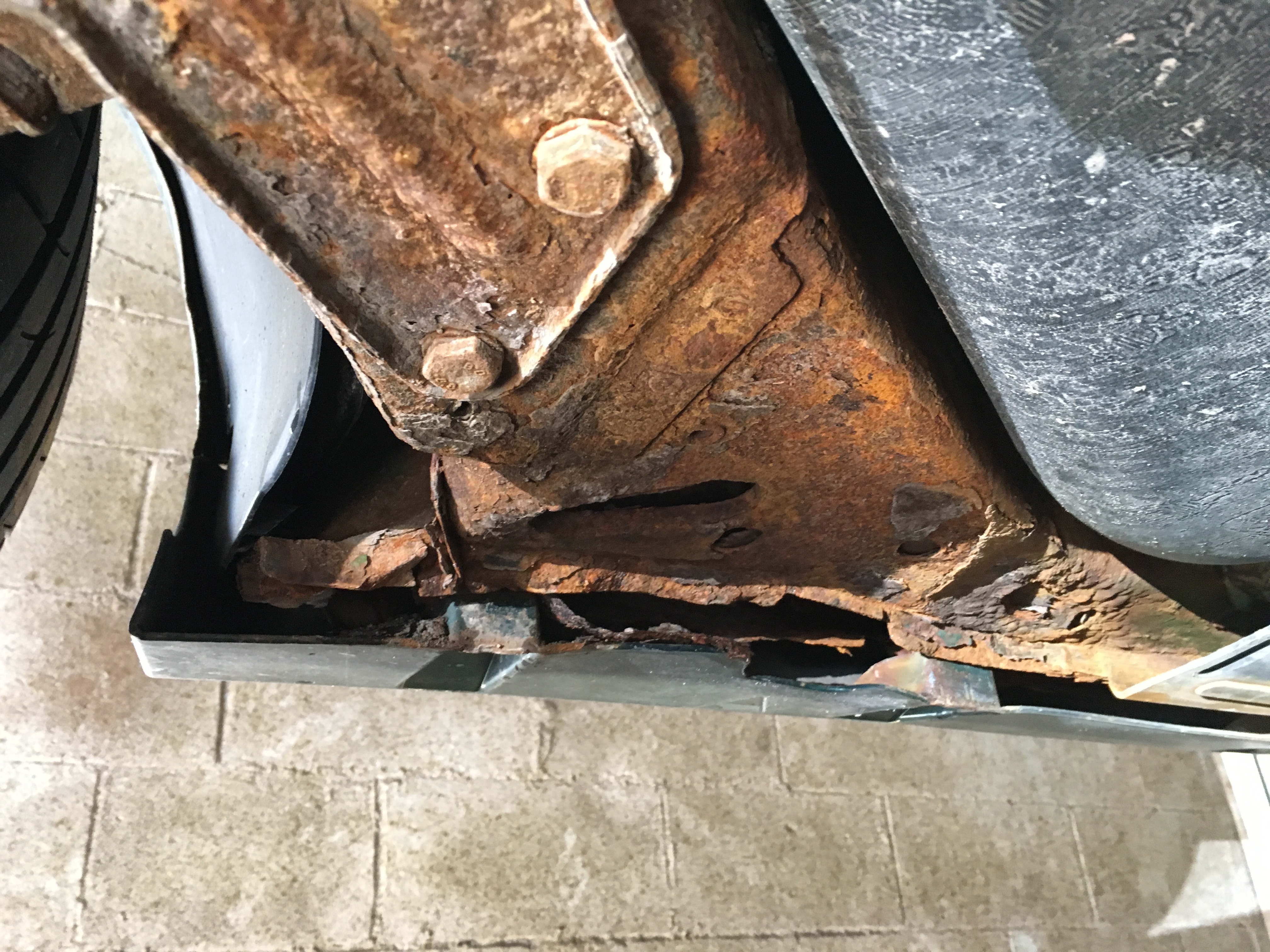

Ok finally got a guy to put it on a hoist ( first guy had me drive out of town 45min and he got on his knees and said thats bad, but I need to put it on the hoist but it is tied up today, but then said it would be $3k and probably more) so the local welder said $1k but could go a bit higher once he remove the plastic underbody- so it goes in next week -fingers crossed- I will try to post a before pic-thx

Forgot to mention that it is the sills and where they attach to subframes- I think the sill assembly is very structural - when I accelerate rapidly or stop quickly I hear the chassis groan and creak and some bad roads now make the doors rattle in there frames-started late last fall, I thought at first shocks (which are one of the last things yet to do) so I hope this fix works-I will post the after photo's

I had a friend recommend a guy for welding in new sills and it has turned out very well -both sides done and some painting (fixed a few bubbles over rear wheels) all in for $1200 - he did a better paint match than the premier shop that re-painted a rear door after my boss scuffed it! I am so relieved and happy that I will get him do do the same to my RX7! Sorry no in progress photos- I was called into work and couldn't get there.
