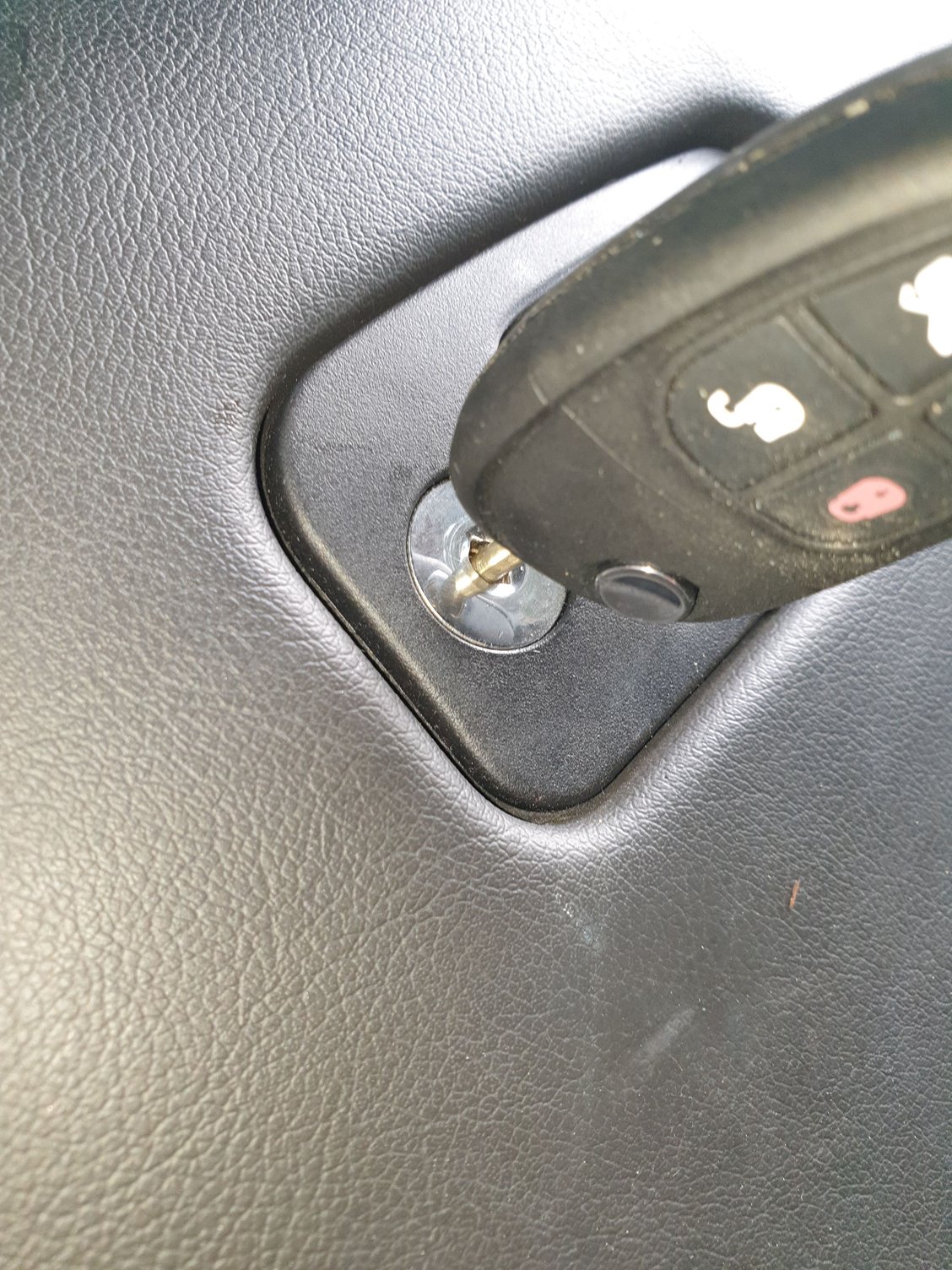

I finally figured out why my truck release button was not working
After reading information from everyone who tried to help
A massive THANK YOU
this is what I have found out and the difference between my 2002 str and my 2004 4.2 N/A s types
And hopefully it might help someone in the future

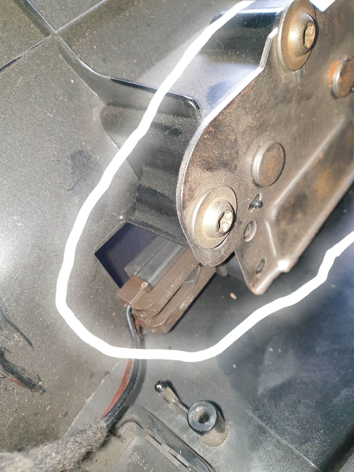

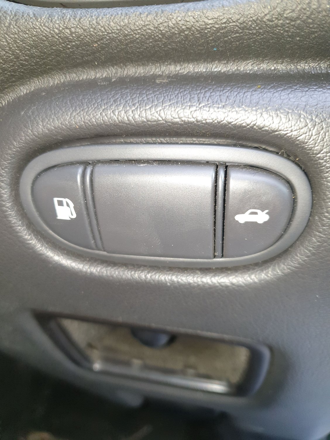

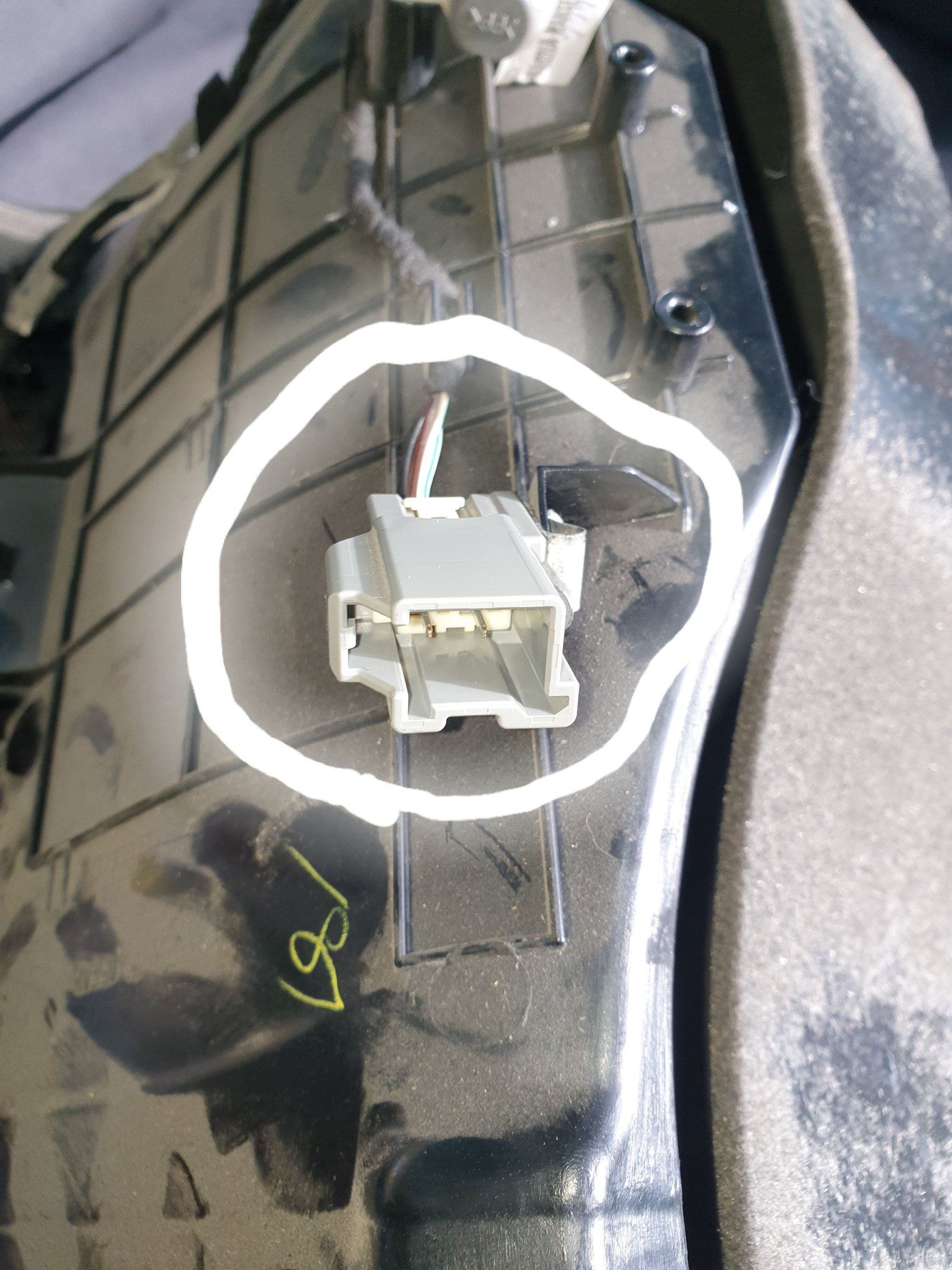

My 2002 str dose have a Valet button like most of you said
My 2004 dose not have the Valet button
And since I had the glove compartment out the trunk release button on dash panel did not work
and there was no Valet button in glove compartment in the 2004
but when I plugged the glove compartment wires back in the trunk release button on side of dash worked
so I tried a little experiment
If I locked the glove compartment with my key it disabled the dash trunk release button so I couldn't use it to open trunk
But when I un locked glove compartment with key dash trunk release button worked
I'm not sure about models after 2004 if they have the same setup but would keen to know
I have attached some pictures
So don't quote me on this but I'm thinking glove compartment lock is the Valet switch
And hopefully this might help someone in the future
Darrol
