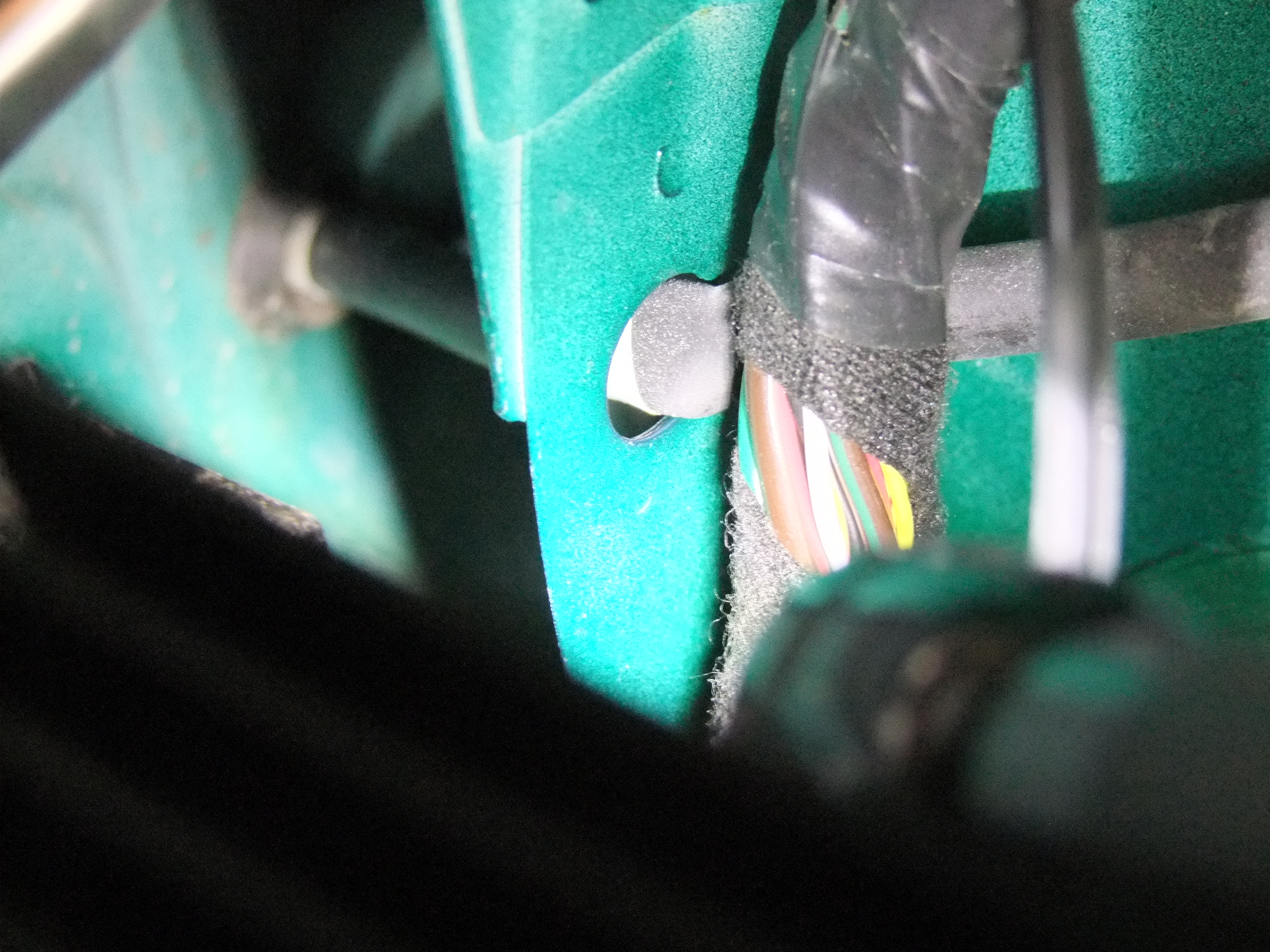

Well here's the entire source of my problem.
That thick wiring harness that's next to the NAV DVD and CD changer presses hard on the flimsy drainage tube and squeezed it completely shut. Once I slid the electronics back and could get access the tube flows air quite freely. But I still need to cut a section out, replace it with a thick wall hose that won't get collapsed and then reinstall everything.
Odd that this completely shut close now after 10 years?
I had dampness in the LR carpet twice before over the last 3 years and then this dampness between the bottom seat cushion and the interior wall, no carpet this time.
It's hard for me to imagine the body shop needing to even touch the electronics in order to get the rear bumper off & on. But who knows ...

That photo I posted doesn't really capture the pinch off well.
When I blew through that tube it was completely blocked though.
IMHO they used the wrong sort of tubing in addition to sloppy assembly.
