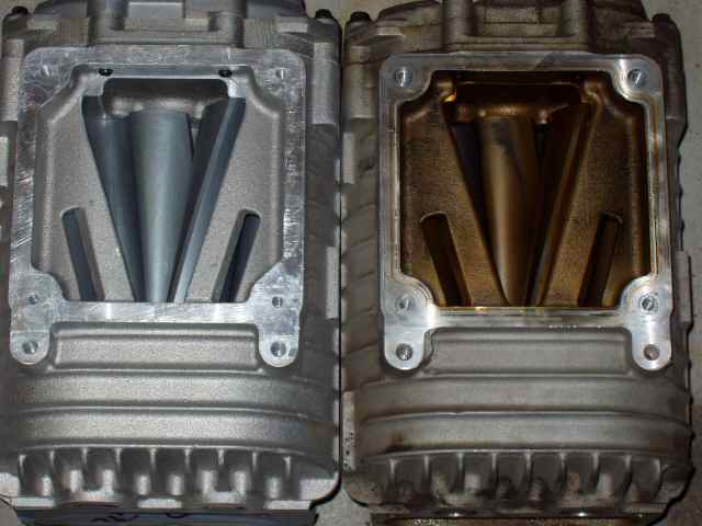

What exactly is plugging the silencer ports? Are these ports on the blower itself or are we talking about the 4 "arms" that protrude from the intake tube? My blower is currently off the car due to the under the S/C coolant leak...
Old Dec 24, 2011 | 08:20 AM
bfsgross's Avatar
Joined: Nov 2009
Posts: 5,084
Likes: 432
From: NY
Regarding: plugging blower vents, I believe V8STR is referring to the blowers internal boost bypass channels. These relieve boost to both not overboost and cut down blower whine. Eaton rebuilders/modders offer to block the bypass vents to accelerate building boost. The end result is more boost at the expense of too much whine for most appetites...ok for a track dedicated car.

Hmmm. So are those ports just for sound? Does it help to build boost quicker?

According to the redline forums who claims they got this from Eaton:
"The two oval slots on the output plate are air leakage ports. Their only purpose is to decrease operational noise from the blower. Arnie, from Eaton Corp., explains their function like this, "When you stomp on the gas, the boost shoots up and the air flow goes supersonic. The air then slams back into the output plate and through the leakage slots, which reduces the hammering of the air into the housing causing less noise. The OEM can not have such loud NVH, that’s why we put them in the housing. The 2 small ports are not there to feed air, only to reduce noise." Basically, for the best flow and most efficiency, these ports can be blocked off, making the outlet port (triangle slot) the only port on the outlet plate of the housing. Closing these ports will not increase IAT's; however, it will make the supercharger much louder when in boost. As an example, aftermarket supercharger companies, such as Harrop, Roush and Magnuson do not use these slots in their blowers. It should be re-stated, that you should consult professionals regarding closing these ports; and do not, for any reason, plug them with JB Weld. Improper closure could eventually lead to pieces coming apart and loose debris destroying the rotors and housing. Opening up these ports will only have a negative effect on efficiency. Do not port them."

A picture might help. Note the big triangle and the two smaller slots. I think these two slots are what they are talking about. This is a ported blower next to a stock one. It's hard to tell any difference and of course there are NO dyno test of any kind to back it up any claims.
Thanks for the visual aid...I guess the question is how (and more importantly how much) to plug the holes...If I could find someone and it needs to be done this tuesday or wednesday only, to weld and grind for like $100 I'm down, but otherwise I may try the epoxy route...
