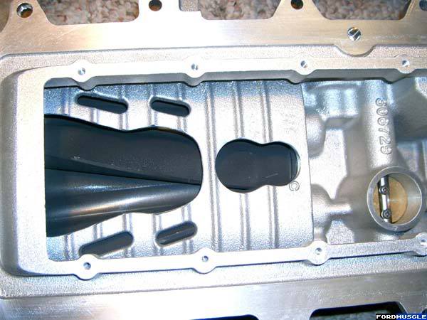

This is a stock M112:
And this is what your blower will look like after Stiegemeier is done with it:

Do they do anything internally or just gring out, like whats in the picture?

Stiegymier (spelling?) checks the internals for wear and will replace worn parts. They offer an internal re-gear of the front section (Snake Bite). What you see in the pics are areas grounded (port and polish) out to increase air intake and velocities= more air pumped-in whilst lowering temps.

First the picture posted is NOT a Jaguar M112!! That is a Ford. I have the correct pictures below. Along with a comparison of stock and a ported version. Not much is done. Be aware that Stiegemeier has treated one of the forum members very badly and I probably WON'T use him because of this. A little searching will turn up the thread.
Here is his web site:
http://www.stiegemeier.com/
Attached Thumbnails  supercharger pulley-2003-s-type-r-engine-supercharger-oulet.jpg    supercharger pulley-steigmyer-ported-blower-next-stock-4.0.jpg
