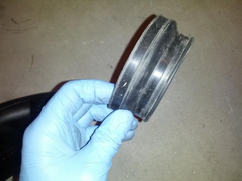

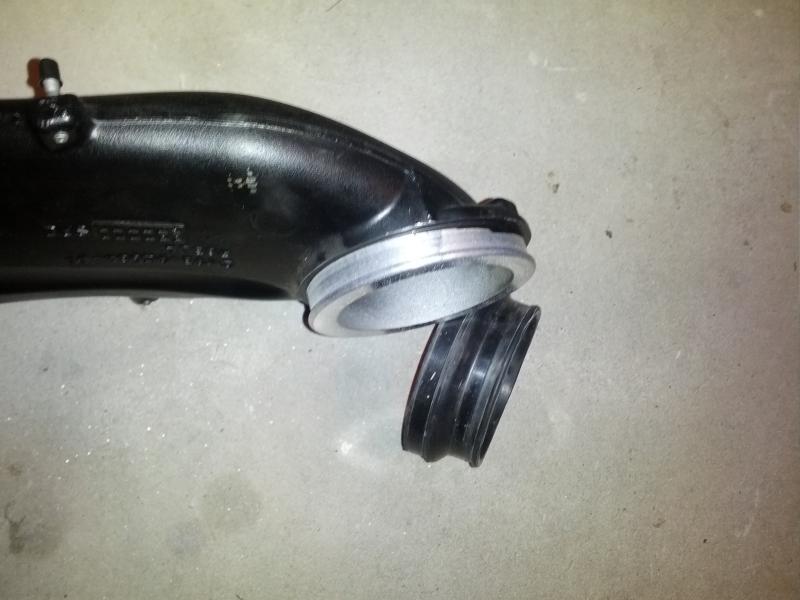

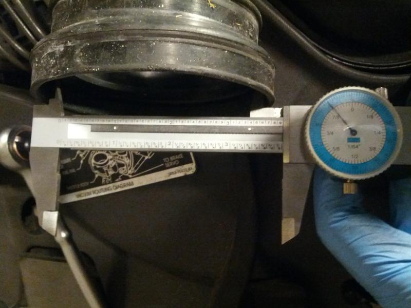

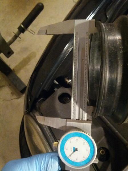

here are the measurements of the TB to intake elbow rubber coupler:
  • the smaller TB side has an ID of 3.38"
  • the larger intake elbow side has an ID of 3.9"
calipers didn't fit too well back on the TB, but a rough check pretty well matches the ID of the rubber coupler, maybe a slightly smaller.
OD of intake elbow 3.93"
