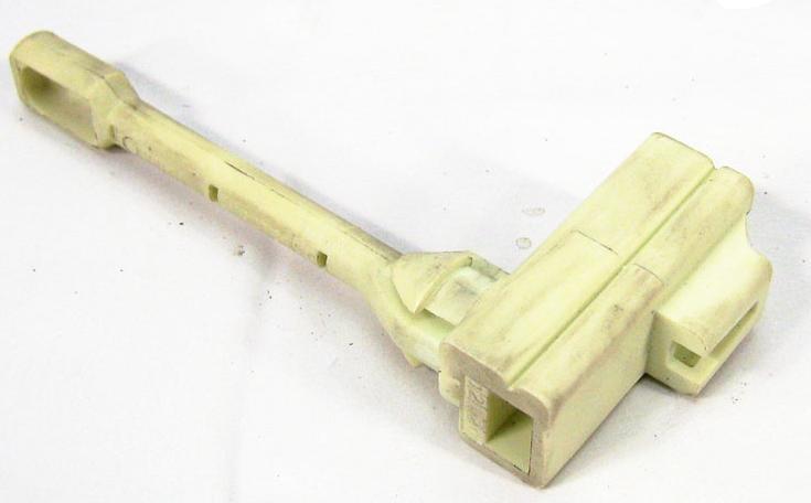

Be aware that there is more than one temperature sensor inside the S Type. I would start with the sensor behind the small grille above where the ignition key goes in. This is the interior temp sensor. Since the air flow is opposite for this one it builds up a layer of crud on the sensor because cabin air is sucked in thru the grille and over the sensor. Will be much worse if the car has been smoked in!!!!
The other 3 temperature sensors are identical but are mounted to the plenum system and only have clean filtered air blown over them as the air exits the dash vents. I changed one of the evaporator sensors and it did not help. The sensor above the key was replaced but I think it could have been cleaned. It had a visible layer of dirt on it. That fixed the problem. The sensors are only about $20 each in the US. Also this is the same part as the Lincoln LS. So you can order this at any Ford dealer. Sensor behind grille above key Ford Part # XW4Z-19C734-AA.
Evaporator sensor part # XW4Z-19C734-BA
See the pictures below. This is the evaporator sensor NOT the sensor above the ignition key. The little bulb part is what gets covered in dirt.
Attached Thumbnails  Temperature problem-2003-s-type-r-inside-temperature-sensor.jpg    Temperature problem-2003-s-type-r-inside-temperature-sensor-plug.jpg

I can tell you without a doubt that 'XW4Z-19C734-AA' will not fit the S-Type. The ford part has only two connections because it only measures temperature. The Jag has four connections because it also measures humidity. Tried to repalce it last night - when I disconnected it and ran the A/C the only differance I noted was the fan speed was on low. Reconnected and fan speed back to normal. The other ford part went it without any trouble, but did'nt resolve issue.
