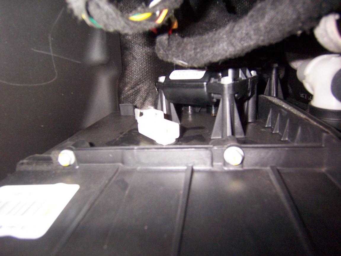

Old Feb 11, 2009 | 02:20 PM
Mike E's Avatar
Joined: Jun 2008
Posts: 47
From: Bay Area, California
where is the sensor located at? all i saw was this
