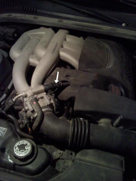

Default Kitty had a vac hose leak causing it to run rough at idle
Well I had the battery checked and it was fine. I started to look around the engine compartment and discovered a small slit in a vacume hose connecting the crankcase vent line to the carb. I am attaching a pic of the hose. It was very inconspictious because it was a very small slit on the under side of the hose. I wrapped it with electrical tape very tightly and coated it with glue for a temp fix. The Kitty now runs smooth at idle...Imagine that!!!. Now I have to go to the dealer to get a replacement hose because I have had no luck locating one online. Thanks for the help and I hope this might help someone with the same problem.

I don't quite understand. You say you fixed a vacuum leak and it now idles. What happened to all the other issues?? I can't see a vacuum leak causing the dim/bright light deal.

The vacume leak caused the engine to run rough at idle. The engine was running so rough that I imagine that the alternator was not spinning fast enough that it would cause the lights to dim and get bright. It was running so rough that it was like it was going to stall at any moment. The codes showed that there was misfire on about 4 cylinders almost stalling, 800 rpm then up to 1200 rpm back to 700 rpm and so on. After the vacume leak was stopped the car ran smooth, the alternator was able to operate at a stable RPM, and the lights quit dimming. The other codes that came up, IE: gear box fault, DSC fault and Traction control error, I don't know what was up with that. But I did charge the battery and I haven't seen the codes since.

Those other codes were likely due to the jerks of the engine (upsets gear box) and the voltage variations. To be expected.
