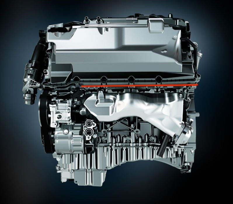

So, my beast is back in my driveway now. She roared to life right off the hop. Inflating the tires to max pressure worked wonders - no flat spots on the tires. Although my spare is out of air. The bounce sheets seemed to keep the critters away too - I still have an intact hood liner - thank God! But I do have an issue - I put plastic down underneath of her because she was stored on concrete. When I backed her out of the garage, there was oil on the plastic sheet. I checked the oil level and I'm down about an 1/8th. A quick look underneath showed some oil leaking from the front of the plastic shield. The oil on the plastic was almost completely dry, but it looked like there was enough for it to run across the plastic. I'm guessing the oil pan is towards the front? Maybe a leaky seal? Frig I hope it's an easy fix.

On a 4.2 I'd have a look at the valve cover gaskets before the oil pan. How long was she parked for?

I had her away for 5 months. Now to check the valve cover gaskets.... um, where are those? Lol. I'll do a search first before you answer

Rob,
Run a CLEAN paper towel along these edges of the block:
(see pic for red line)
Follow that seam all the way around.
Here's what the gaskets look like for more perspective:

Question though, "dried oil"? Did you wash down the engine bay prior to storage? Could it have been dried dirty water that ran off the motor?

Rick - I hadn't washed the engine compartment prior to putting her away, but you do have a point. If whatever had leaked and run were entirely oil, it wouldn't have dried. But there was a spot that was oil - about 4 inches in diameter. What's odd though is that after driving her for two days now, my oil level hasn't changed and there isn't a single spot of oil on my driveway.
I really do need to get her up on my ramps and pull the shield off to have a look around. I'll keep everyone posted with what I find.
