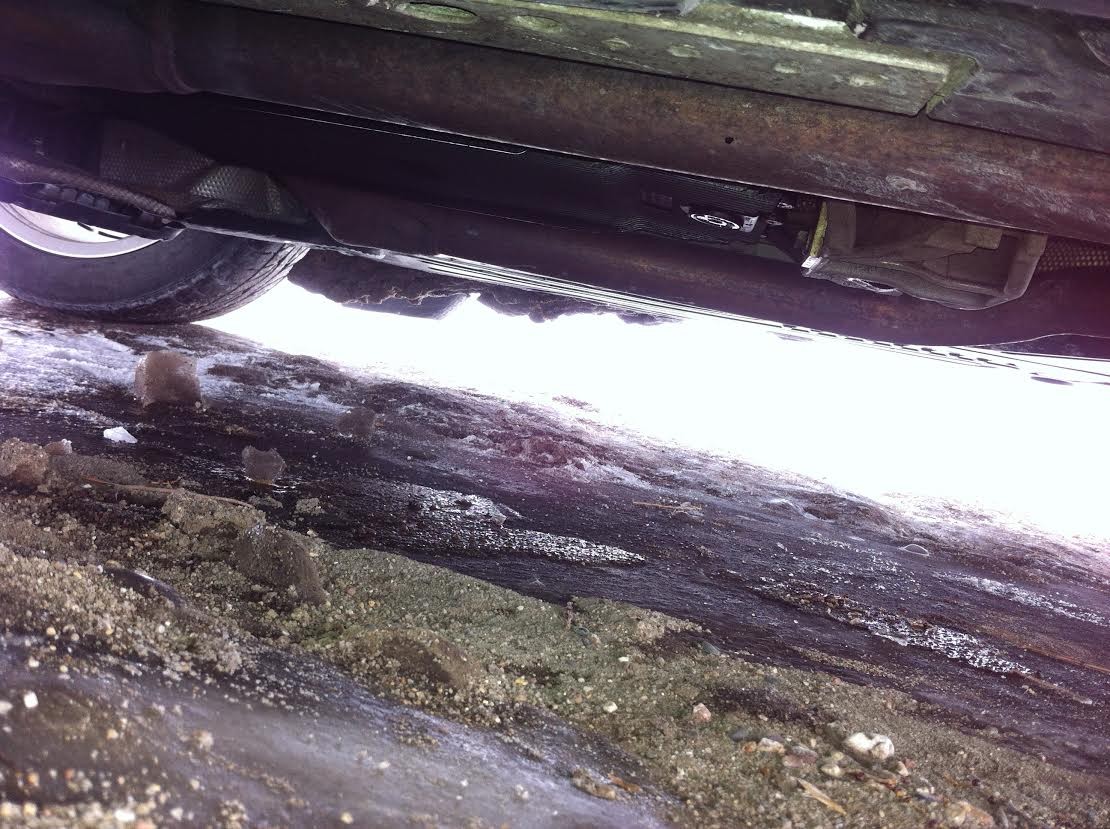

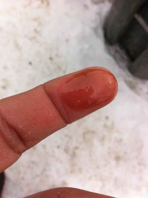

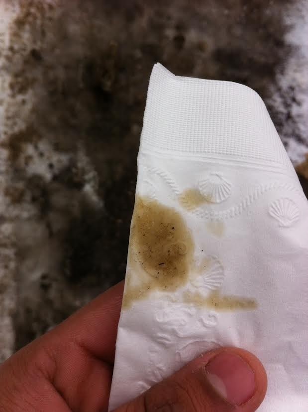

I noticed some type of oil/fluid on the ground where I park my S-Type today and I'm not sure if It's trans fluid or engine oil, I'm the only one who parks here so It's coming from the s-type...It has an oil consistency to it...I can't describe the smell or else I would =) I know the trans is due for a new trans fluid/filter/pan change but I was hoping I could do it once I hit 90K...(currently at 88,168) but if it in deed is trans fluid then I'll have to get it done ASAP. I took some images hoping someone could tell if what it is and where it's coming from ! I believe the black particles on the napkin/finger is just dirt...or at least I hope so !
Thanks for any help !
In this photo I drew an outline of where the car sits in red and the yellow spot is where the oil is.
Attached Thumbnails Trans Fluid or Engine Oil Leaking ?-cebe.jpg   Trans Fluid or Engine Oil Leaking ?-mcog.jpg   Trans Fluid or Engine Oil Leaking ?-v3su.jpg   Trans Fluid or Engine Oil Leaking ?-cev2.jpg   Trans Fluid or Engine Oil Leaking ?-9oxq.jpg

I would put the car on jack stands if possible and check underneath the vehicle. More than likely a leaking rear crank seal - leaking oil down to the trans bell housing area.
Old Mar 2, 2014 | 11:55 AM
joycesjag's Avatar
Joined: Feb 2009
Posts: 8,020
Likes: 1,731
From: Sunny South Carolina
To me, judging from the last picture, it looks like the transmission electric seal. Lifeguard 6 ATF is a golden color very similar to motor oil.

Why not get the car up on a lift and see what is really leaking! It could also be a valve cover gasket.

A lift is the problem !
