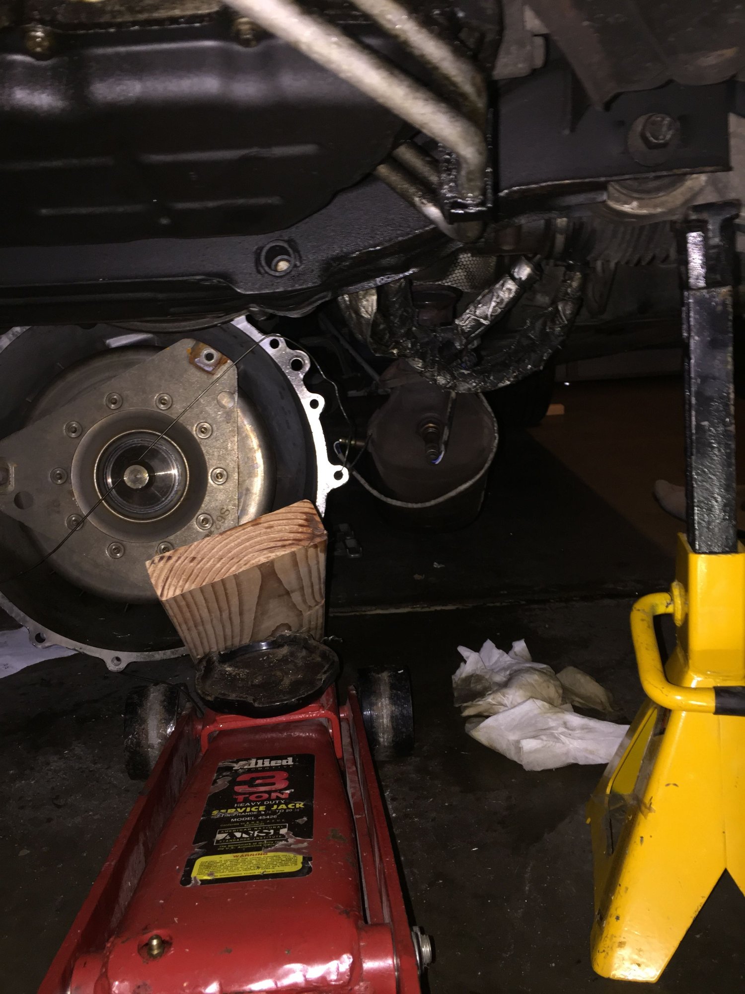

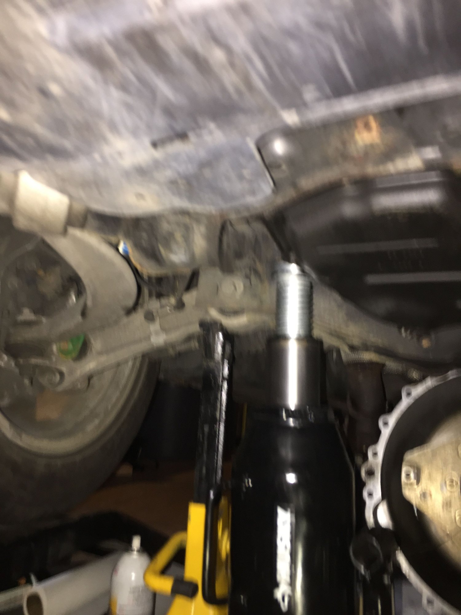

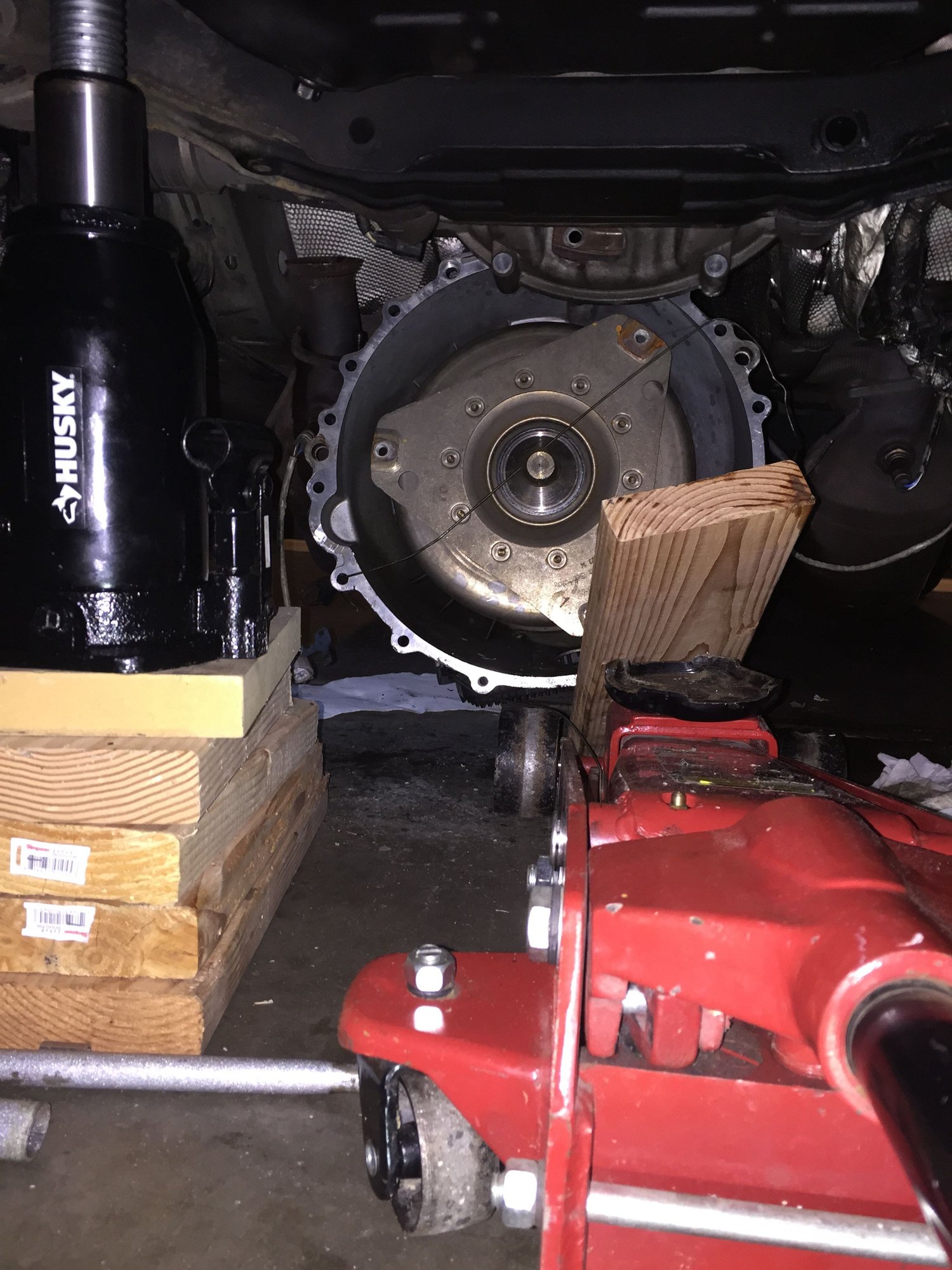

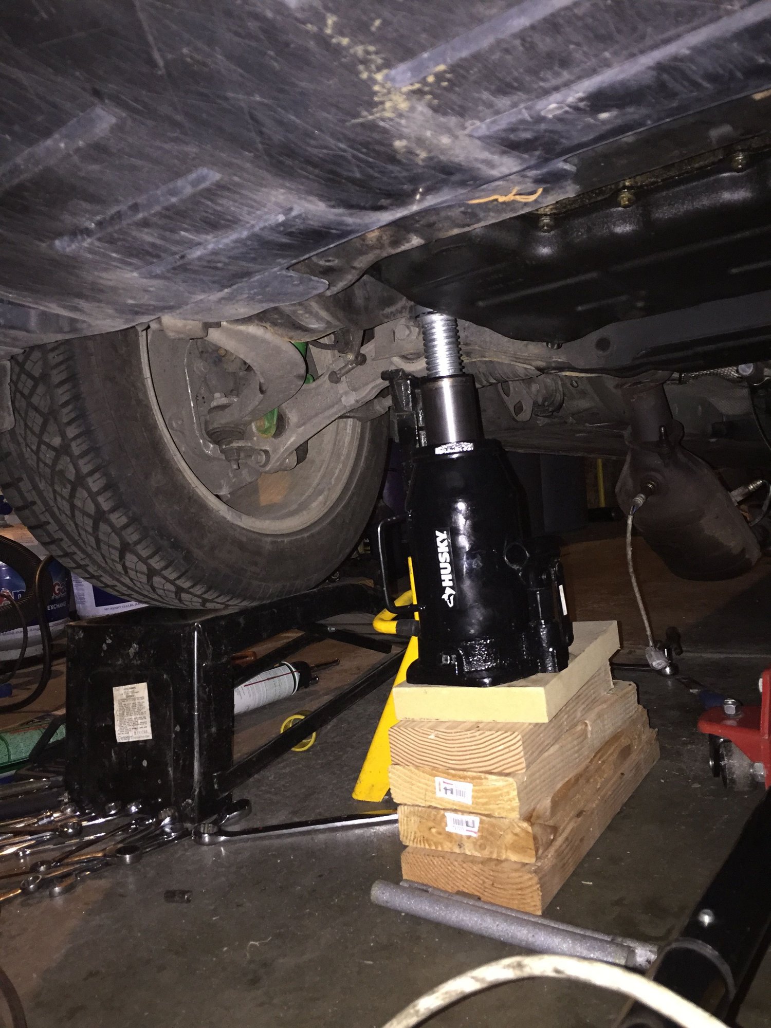

Default Pics of jack setup for removing ZF 6HP26 automatic transmission
Hydraulic jack supporting front of engine so that it didn't shift down when I removed the transmission, Jackstand behind jack
Lowering the transmission to the floor, needed to get it off the floor jack underneath the car

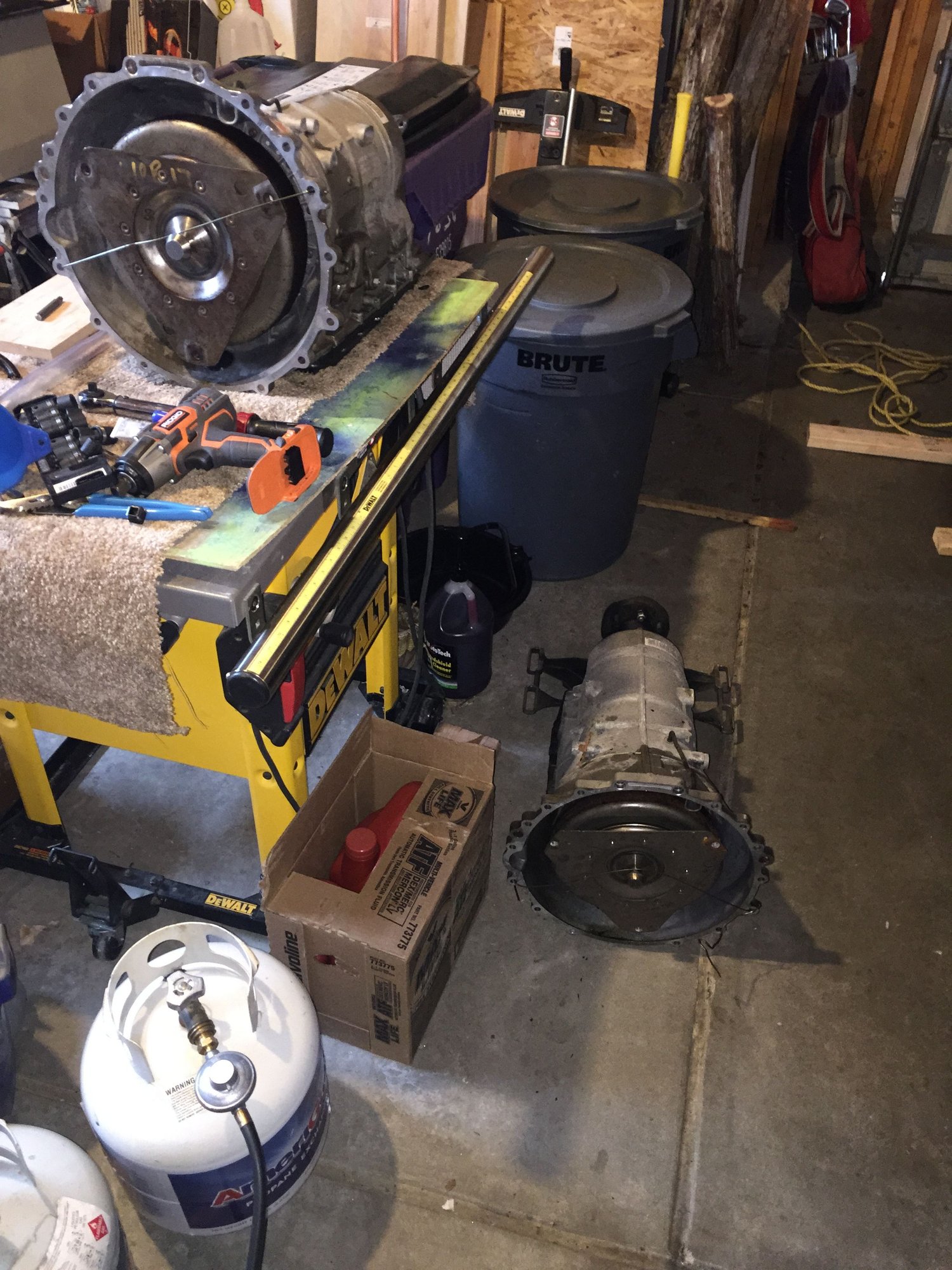

Originally Posted by Chidestp
I'm no expert cpears but I jacked up the front wheels and put ramps under them, then I jacked up front even more to about 1 or 2 inches above ramp and put jack stands under. I have a floor jack under the transmission and a hydraulic jack under the front edge of the motor to hold the position of the motor once the transmission is removed...For the top four bolts you need a 13mm socket on the end of a 2 or 3 ft extension (Autozone has 20" extension - you can get 30" at other places) to get to the bolts on top from the driveline end....The car has to be up high enough to get the transmission out from the front or sides...maybe 18 to 20"...

Finally got the transmission out...yes there were a couple of rusty dowels in the larger holes of the bell housing corroded out...used lots of penetrating oil as well as well as wedges, screwdrivers, putty knives, even a sharp ax!!!

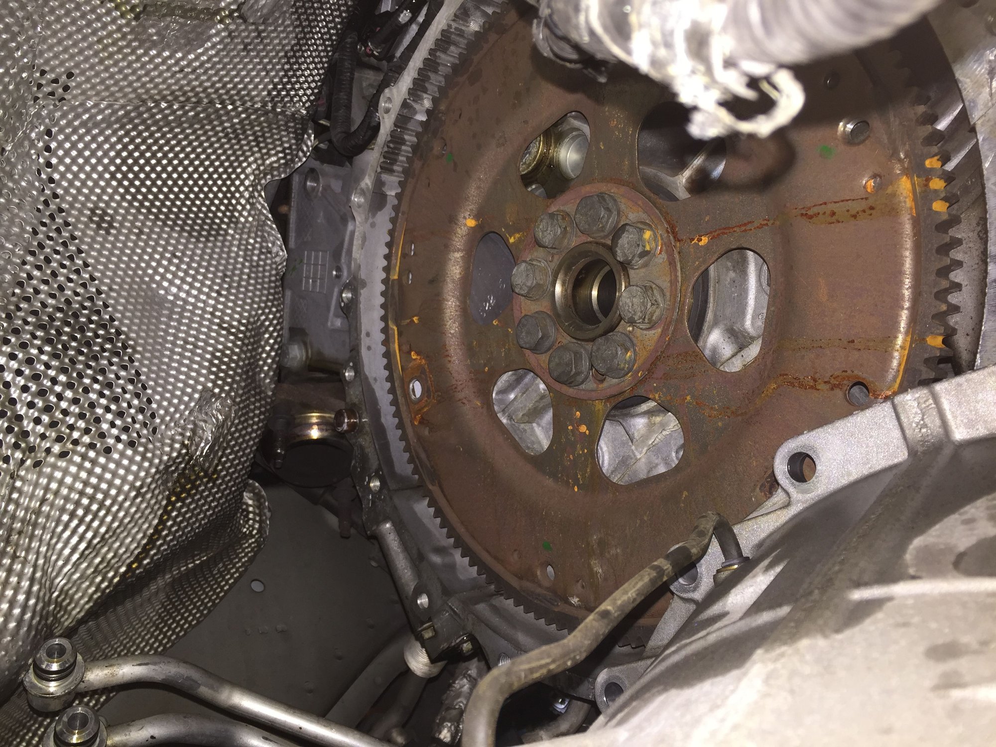

how did you gain access to the three bolts on the torque converter? looks like there were three in a triangular pattern?

Originally Posted by cpears
Thanks for the great info. I am in the process of gathering the needed supplies. I will order up some long extensions for the job. I think getting the exhaust off and out of the way sounds like the most troublesome part from what I have read up on. I plan on replacing the torque converter so maybe I don't need to completely remove the trans from under the car, just lower it enough onto the ground to remove the converter and install a new one.
I didn't completely remove the exhaust, I just dropped down the two pipes as well as the cross member support and the removed the hanging supports from the rubber sleeves in the far back. Left the middle supports in the rubber sleeves between the exhaust pipe and mufflers in place to hang the exhaust in place.
