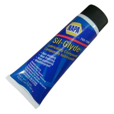

The trunk opening hardware has not changed on the S Type from beginning to end. The gas struts at least on my STR are dampers to slow the opening of the trunk. Springs do all the work.
I would do two things. Lubricate the hinges and the latch. I use white Lithium grease in a spray can. Then clean and treat the rubber seal. I use a product called Sil-Glyde from NAPA.
